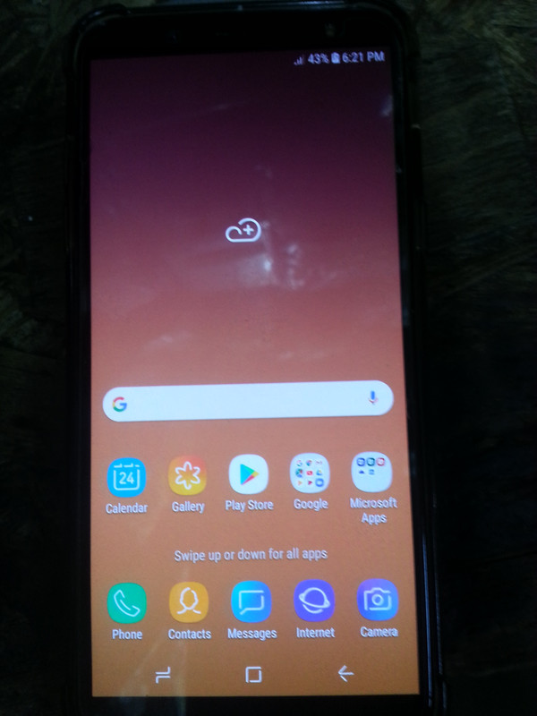

A600g frp done kay Z3X

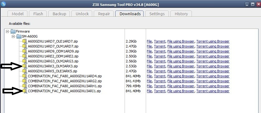

1. download po ng combination at official firmware s support
binary 3 po kya ito dnownload ko

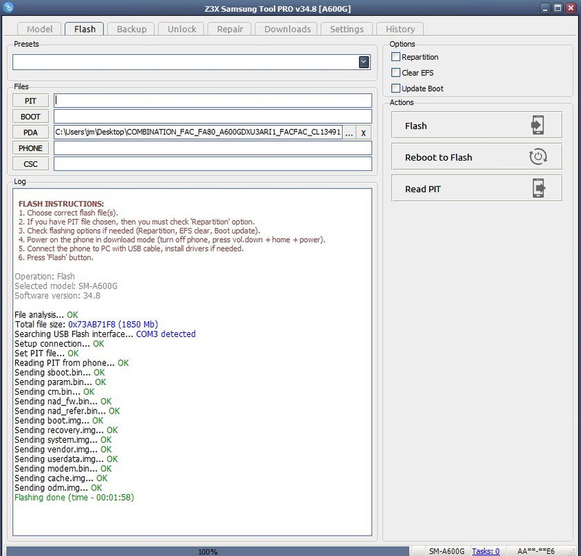

2. flash combination file
3. after flash open settings iopen ang Developer options
enable Oem unlock.

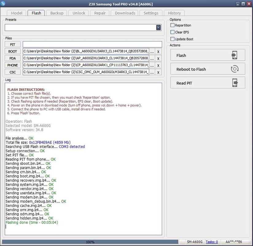

4. flash n po ang ang firmware
5.done n po...
