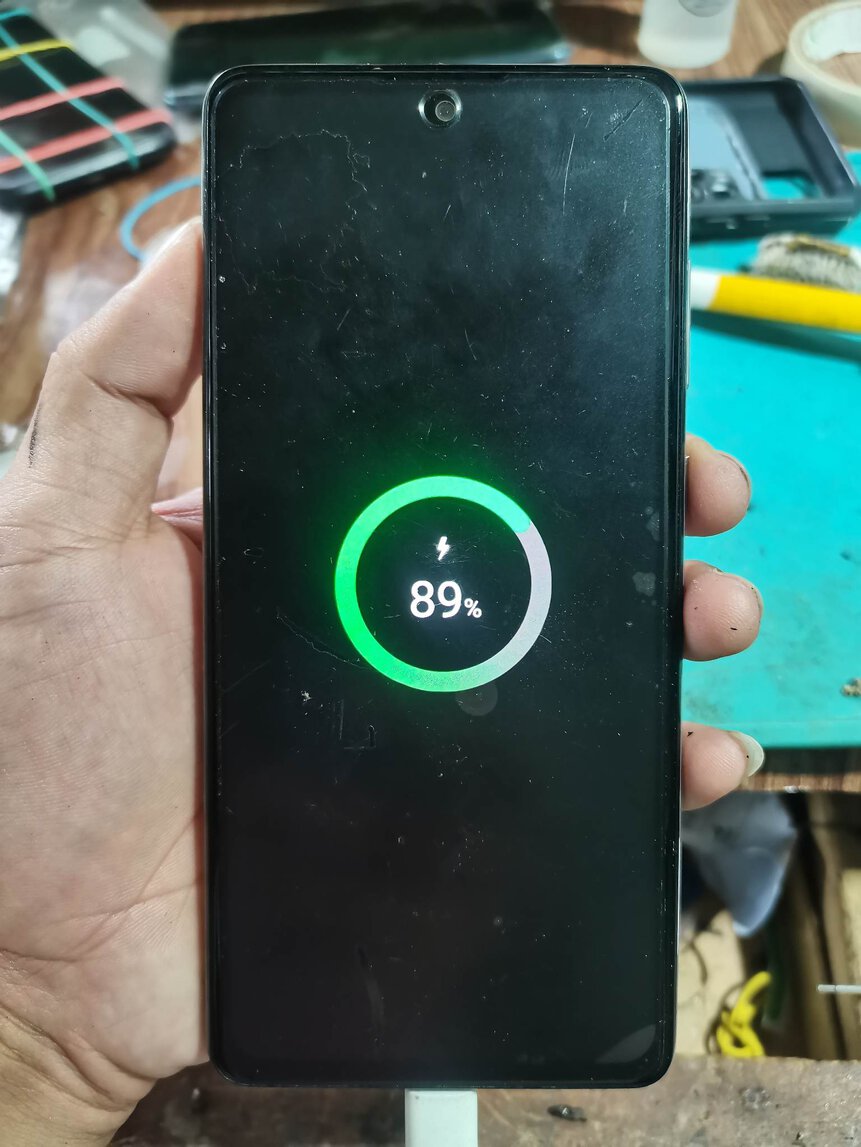

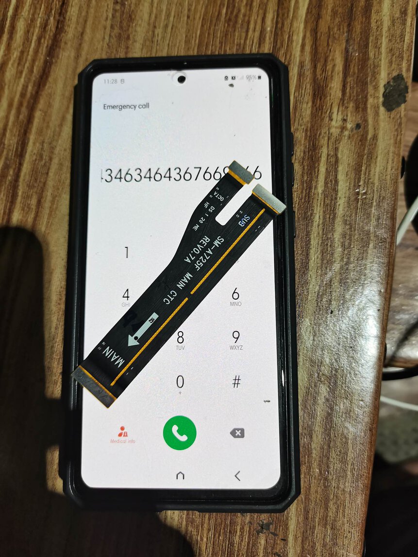

minsan nag chacharge minsan din ayaw nag try na charging board same issue, ayaw din mag touched minsan kaya replced connector Flex cable

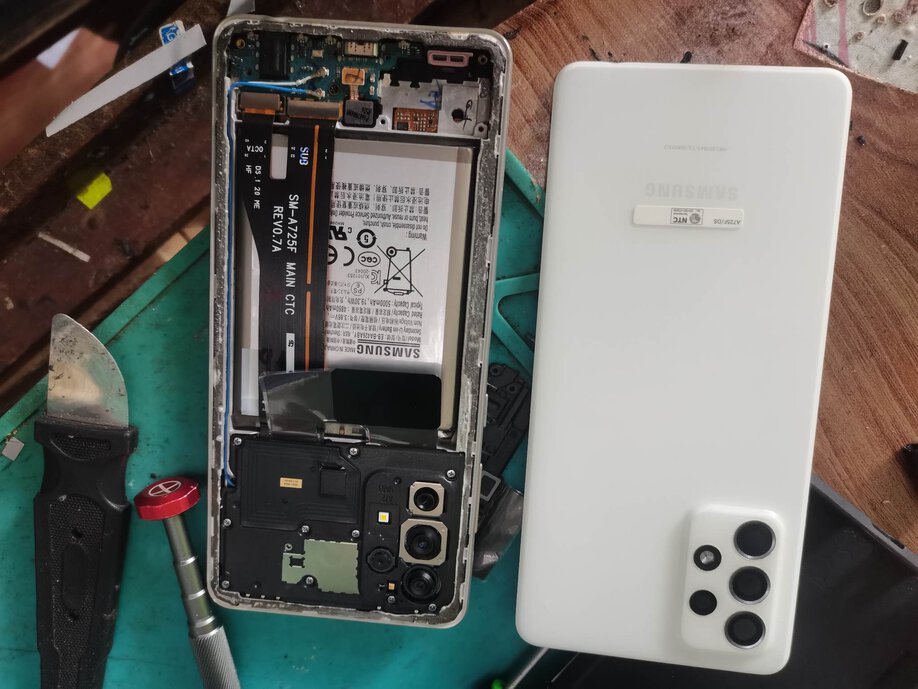

Ask lng boss my tnggap den aq a72 mnsan ngkkarga sya kaso Wla react sa schematic. Mnsan nnwla din.. posibleng flex lng din ba???minsan nag chacharge minsan din ayaw nag try na charging board same issue, ayaw din mag touched minsan kaya replced connector Flex cable

Try Mo muna linisan port boss baka ma dumi pero kung wala padin flex mura lang naman flex possible din talaga flexx kasi oag charging board agad mahal eh tryAsk lng boss my tnggap den aq a72 mnsan ngkkarga sya kaso Wla react sa schematic. Mnsan nnwla din.. posibleng flex lng din ba???
Online lng dol 200 plusLods san ka nakabili ng flex ng A72?
