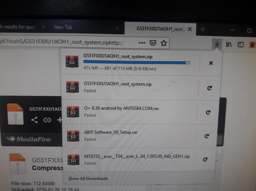

link ; http://www.mediafire.com/file/9atdar8y61hcxh5/G531FXXU1AOH1_root_system.zip

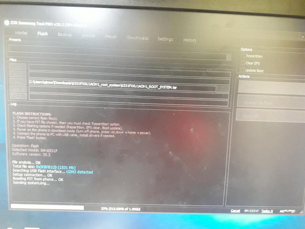

FLASH INSTRUCTIONS:
1. Choose correct flash file(s).
2. If you have PIT file chosen, then you must check 'Repartition' option.
3. Check flashing options if needed (Repartition, EFS clear, Boot update).
4. Power on the phone in download mode (turn off phone, press vol.down + home + power).
5. Connect the phone to PC with USB cable, install drivers if needed.
6. Press 'Flash' button.
Operation: Flash
Selected model: SM-G531F
Software version: 35.3
File analysis... OK
Total file size: 0x5FBFB1C0 (1531 Mb)
Searching USB Flash interface... COM3 detected
Setup connection... OK
Reading PIT from phone... OK
Sending system.img... OK
Flashing done (time - 00:01:39)
Done with Samsung Tool PRO v.35.3

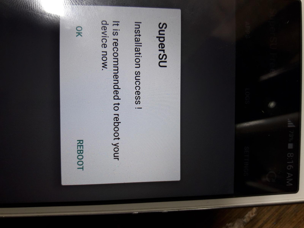

Phone must be rooted!
If the software can't root the phone automatically,
then you must root your device manually.
