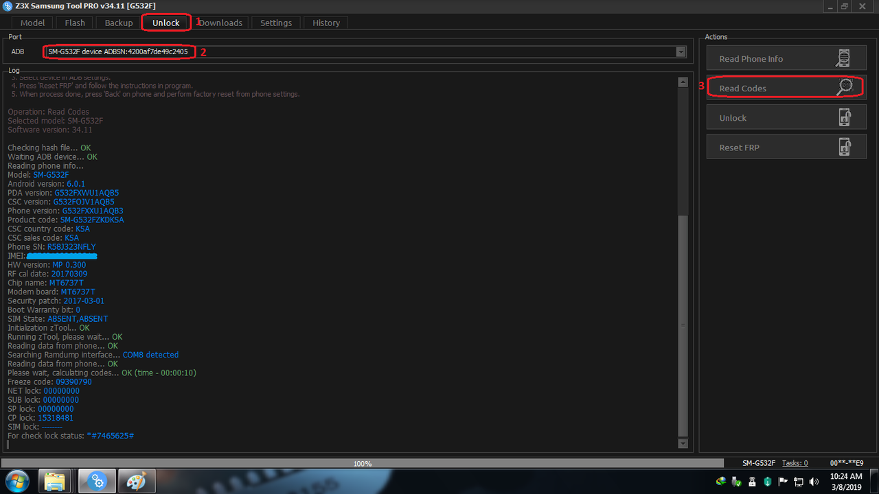

1.) samsung g532f galing saudi po, done via z3x pro read codes only
2.) sure to switch on po yung "usb debugging" pa mabasa po adb nya sa z3x
3.) select correct unit model po sa z3x window
4.) select adb then click "read codes"
