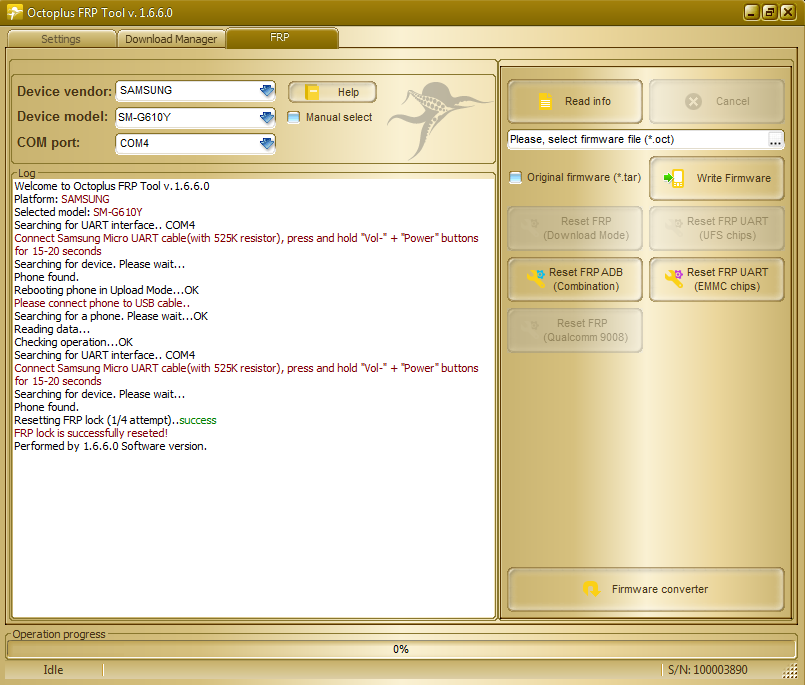

samung g610y frp problem,no files needed,just octo frp tool
---sa software---
open octoplus frp tool
sa device vendor,select samsung
sa device model,select g610y
sa com port huwag na galawin.
---sa phone---
just power it off
---balik sa software--
click ''reset FRP UART''
---sa phone---
press volume down + power sabay connect gamit ang uart cable with 525k or 619k resistor
wait na magconnect then follow software instructions..
