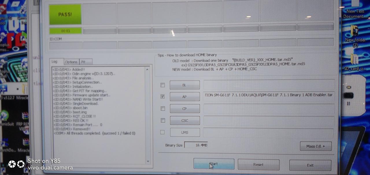

Open Odin or Z3x Then Load Adb Enabler on AP Tab then FLASH
After Flashing Adb is ON
