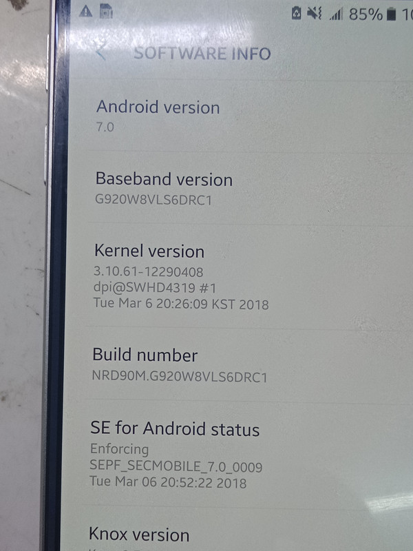

share lang for reference
Samsung G920W8 Galaxy S6 unlock done sa Z3x pro

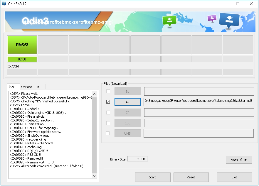

download nyo po dito yung root file
https://download.chainfire.eu/790/C...uto-Root-zerofltebmc-zerofltebmc-smg920w8.zip
kelangan i-root para ma unlock

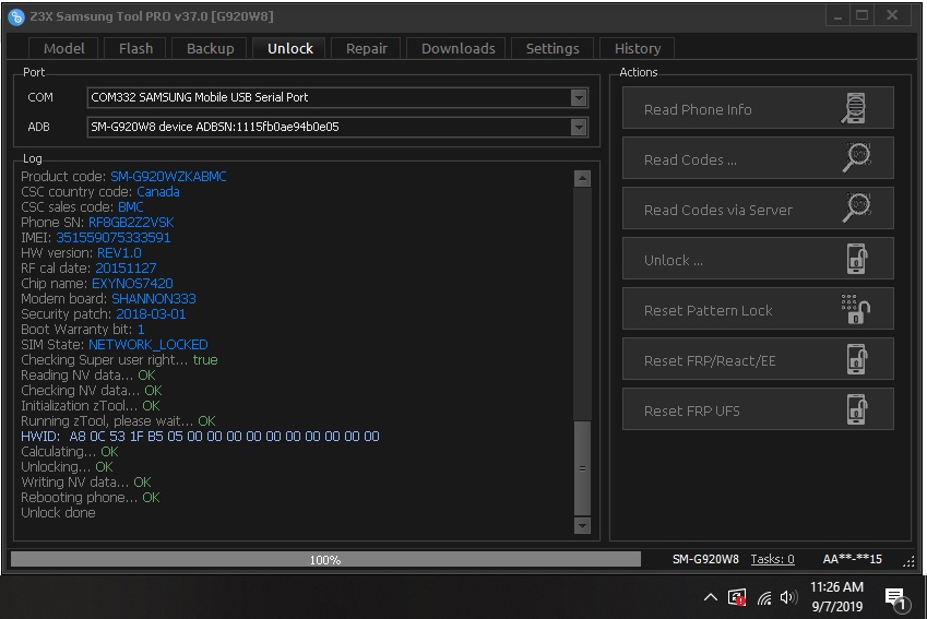

pagkatapos i-root
enable usb debugging
open z3xpro
select correct model
select Unlock Tab
insert usb to unit
select adb
i-authorize mo yung adb sa unit
click unlock

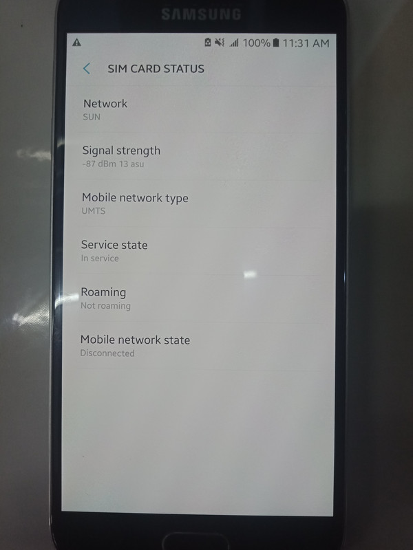

antayin matapos
done na
