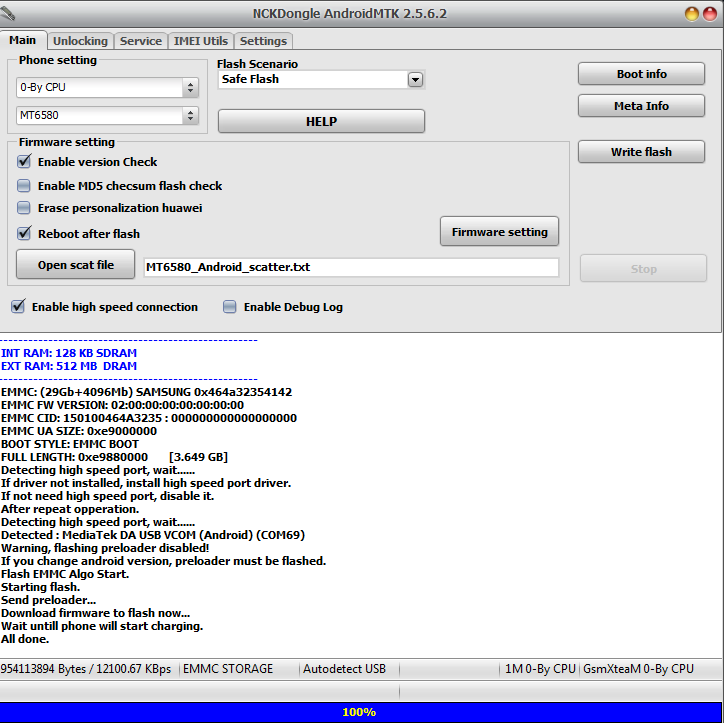

Created by Infinity-Box (c) Chinese Miracle II (c) 2016
Device Brand : X-BO
Device Model : X-BO
Device CPU : MT6580
Device IntName : A9
Device Version : 6.0
Device Compile : 8/19/2016 4:03:19 AM
Device Project : ALPS.L1.MP6.V2_YUANDA6580.WEG.L_P2
Device ExtInfo : A9

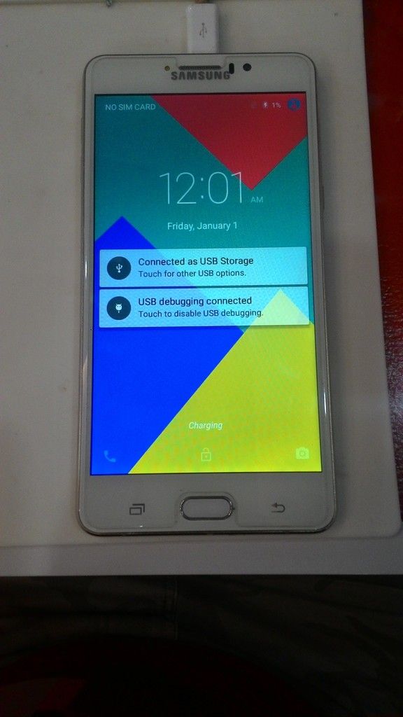

HISTORY: Nag download lng daw c tumer tas biglang nag hang,,dinala sakin naka adroid upgrading na lng..
try q mag search kasu wla aq mahanap na same Device project or build number ..kaya format muna using cm2>....:D:D:akalain mo tumuloy hahah=))=))=))
BACK UP Q NA RIN UN FLASH FILE pra sa inyu mga Papsss:D:D
