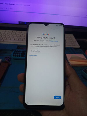

REFERENCE Samsung Galaxy A02S (SM-A025F) FRP Locked Done via Unlocktool

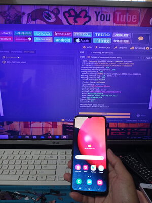

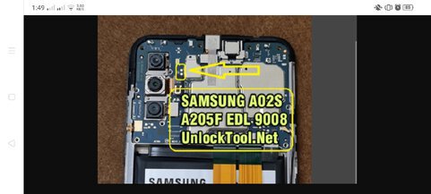

if may Password or Pattern Hardreset mo muna
1.Baklas Phone tanggal Battery Connector
2.Open Unlocktool search exact model
3.Click [EDL]Erase FRP
4.Short Testpoint Using Tweezer
5.Connect Usb Cable
Then pag ma detect na ng UT ang Phone disconnect mo na tweezer sa Testpoint and Wait sa Result
