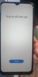

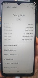

Share ko lang po ito mga boss

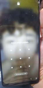

Samsung galaxy A03s sm-a037f password problem
Ito po ginawa ko

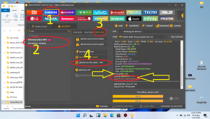

1.Open: UnlockTool
2.Select: brand samsung
3.Search: Samsung Galaxy A03s brom
4.BROM I EDL tab
5.Click: [BROM] FACTORY RESET + FRP

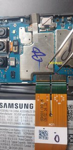

6.Testpoint and connect usb cable and wait it Done
TP.
tangal battery
kung mapapansin, ung
Erasing FRP ok,then ung Erasing USERDATA fail

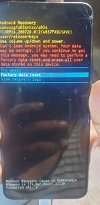

wag mag alala pag open ng unit lalabas Recovery mode
then Factory data reset nalang ng manual
Factory data reset
after reset all data antayin lang and setup
wala narin frp yan
