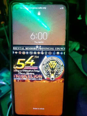

share ko lang mga boss dala ni tumer bigla nalang daw hindi nag charge
samsung GALAXY A21s, first try ko muna charge pero wala nga

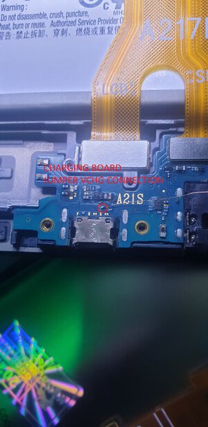

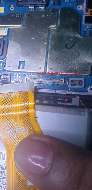

pero may napansin ako pag didiinan ko ung main flex nag chacharge

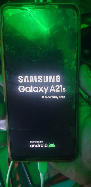

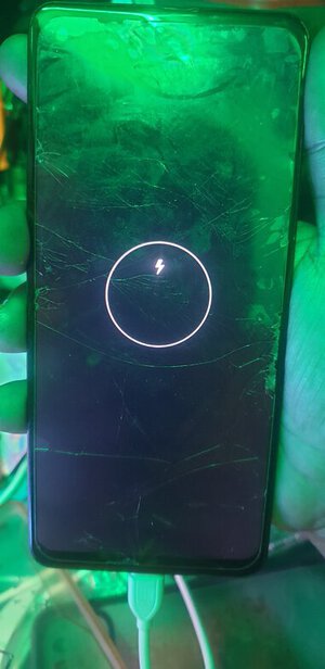

kaya jumper nalang from charging board (VCHG) TO Main board (VBUS) at hindi nMn nabigo
view ss
