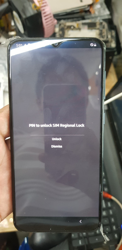

PHONE MODEL : SM-A307FN
PHONE STATUS : UNLOCK PROBLEM FROM KSA

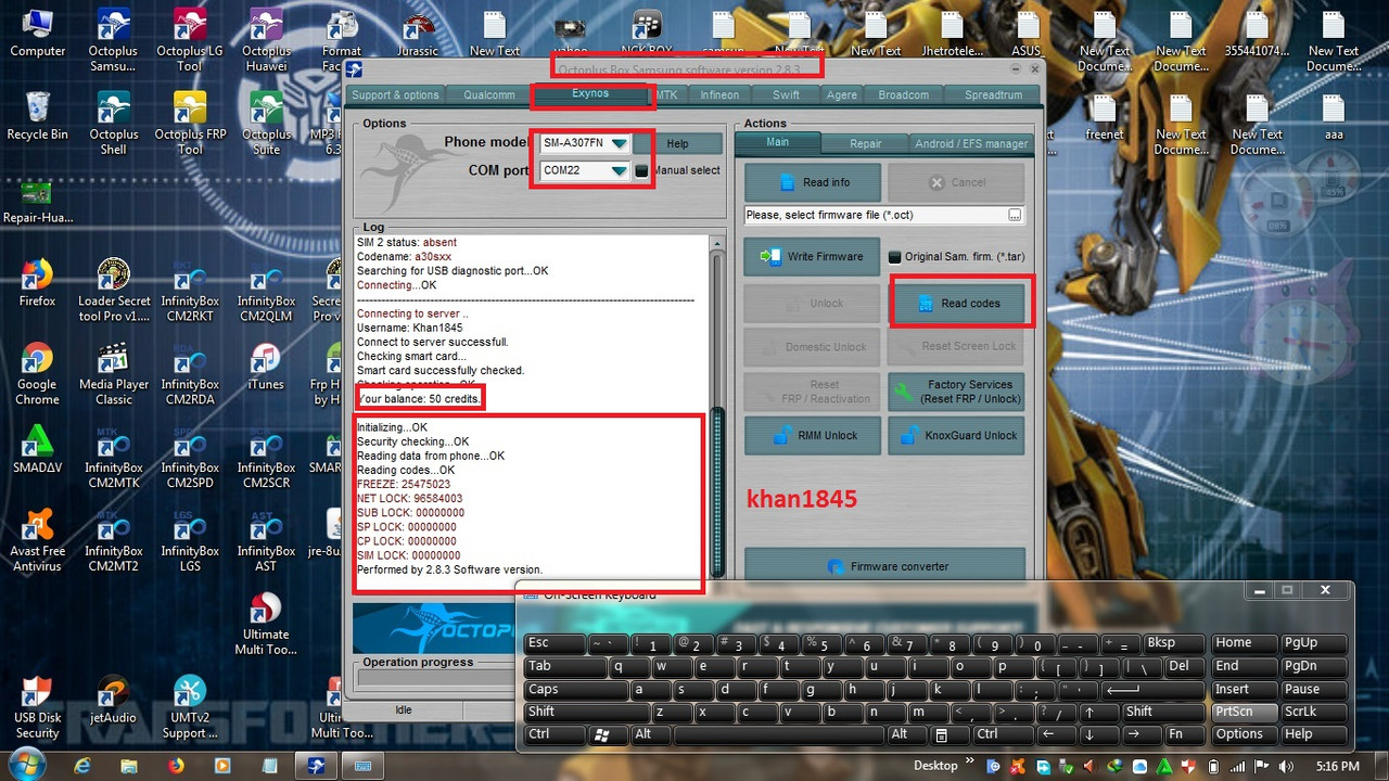

TOOLS:
1- OCTOPLUS BOX
2- SERVER ACCOUNT
3- CREDIT NEED 50 MINIMUN
PROCEDURE:
log's
Platform: Samsung Android
Selected port: COM22
Selected model: SM-A307FN
Operation: Read Codes - Diag ADB - Server
Please, press "OK" button on the phone to allow USB debugging.
Detected phone model: SM-A307FN
Firmware compiled date: Wed Sep 4 18:49:48 KST 2019
PDA version: A307FNXXU1ASI2
CSC version: A307FNOJM1ASI2
SW version: A307FNXXU1ASI1
Phone SN: RZ8M913BD1P
Android version: 9 (PPR1.180610.011)
Sales code: KSA
Country: KSA
HW platform: exynos5
HW Chip: unknown
HW Modem: SHANNON327
Security patch level: 2019-08-01
Warranty Void: 0
SIM 1 status: absent
SIM 2 status: absent
Codename: a30sxx
Searching for USB diagnostic port...OK
Connecting...OK
Connecting to server ..
Username: Khan1845
Connect to server successfull.
Checking smart card...
Smart card successfully checked.
Checking operation...OK
Your balance: 50 credits.
Initializing...OK
Security checking...OK
Reading data from phone...OK
Reading codes...OK
FREEZE: 25475023
NET LOCK: 96584003
SUB LOCK: 00000000
SP LOCK: 00000000
CP LOCK: 00000000
SIM LOCK: 00000000
Performed by 2.8.3 Software version.
