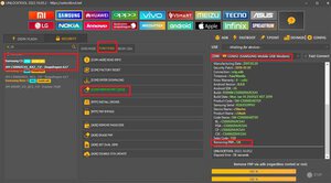

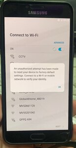

1. Hard Reset Unit

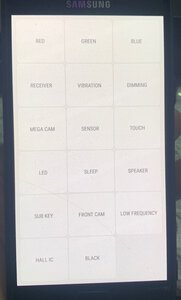

2. On Emergency, Dial ^#0*#
3. On Unlock Tool select Samsung, Model, Functions, [COM] REMOVE FRP (2022)

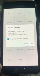

4. When prompted on the CP with USB Debugging, please mark check and press OK.

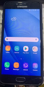

Please see attached screenshots for further details.
