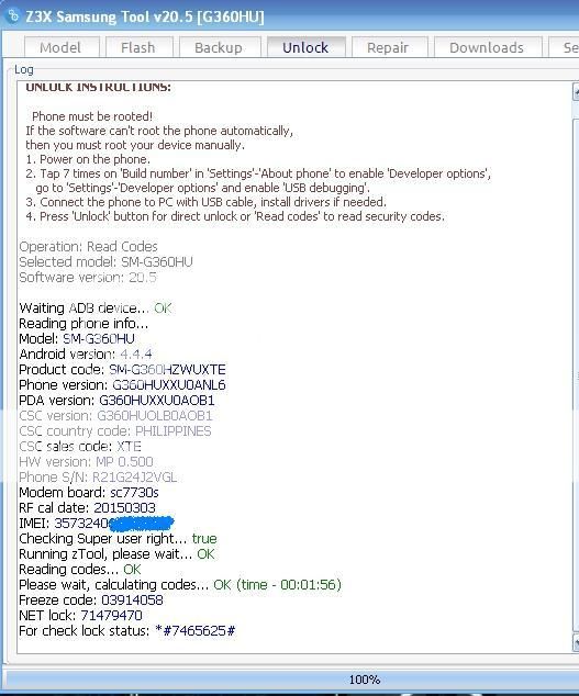

Samsung Galaxy core Prime SM-G360HU unlock done!!!
nice boss buti hnd nag null imei beta lng kc ang z3x now
NOTE...
Ang alam q d po lahat compatible ang root file double check nyo rin build nunber kung compatible ang root file...
follow this procedure nlang po for safe unlocking without root...done kay octopus.

sir ano po ung z3x nyo ung old ba or ung bagong z3x?
supported kya sa dating z3x pag unlock galaxy core prime?
