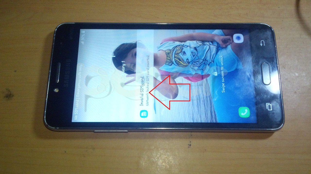

Samsung Galaxy J2 Ace G532G Globe Network Lock
Problem : Globe Network Lock
Solution : Unlock via Read Code

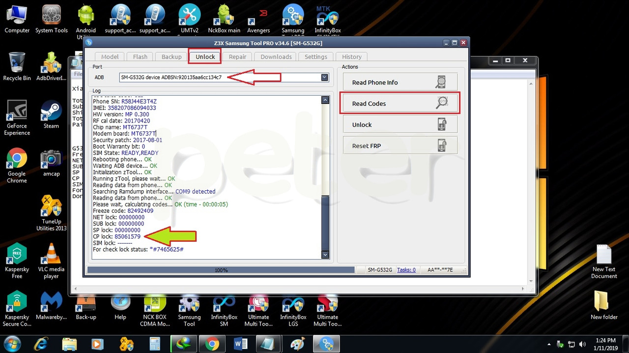

Tools : Z3X Box
CA-101 Micro USB Cable
Procedures : Run Samsung Tool PRO
Select Correct model
Click Unlock Tab
Power Phone On
Enable Phone USB Debugging
Dial *#0808# then select DM+ACM+ADB click OK
Insert CA-101 Micro USB Cable
Click Read Code Button
Wait till Unlock Code appear
Enter Unlock code in phone

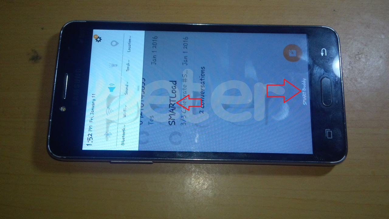

Finish Product :
Done....
