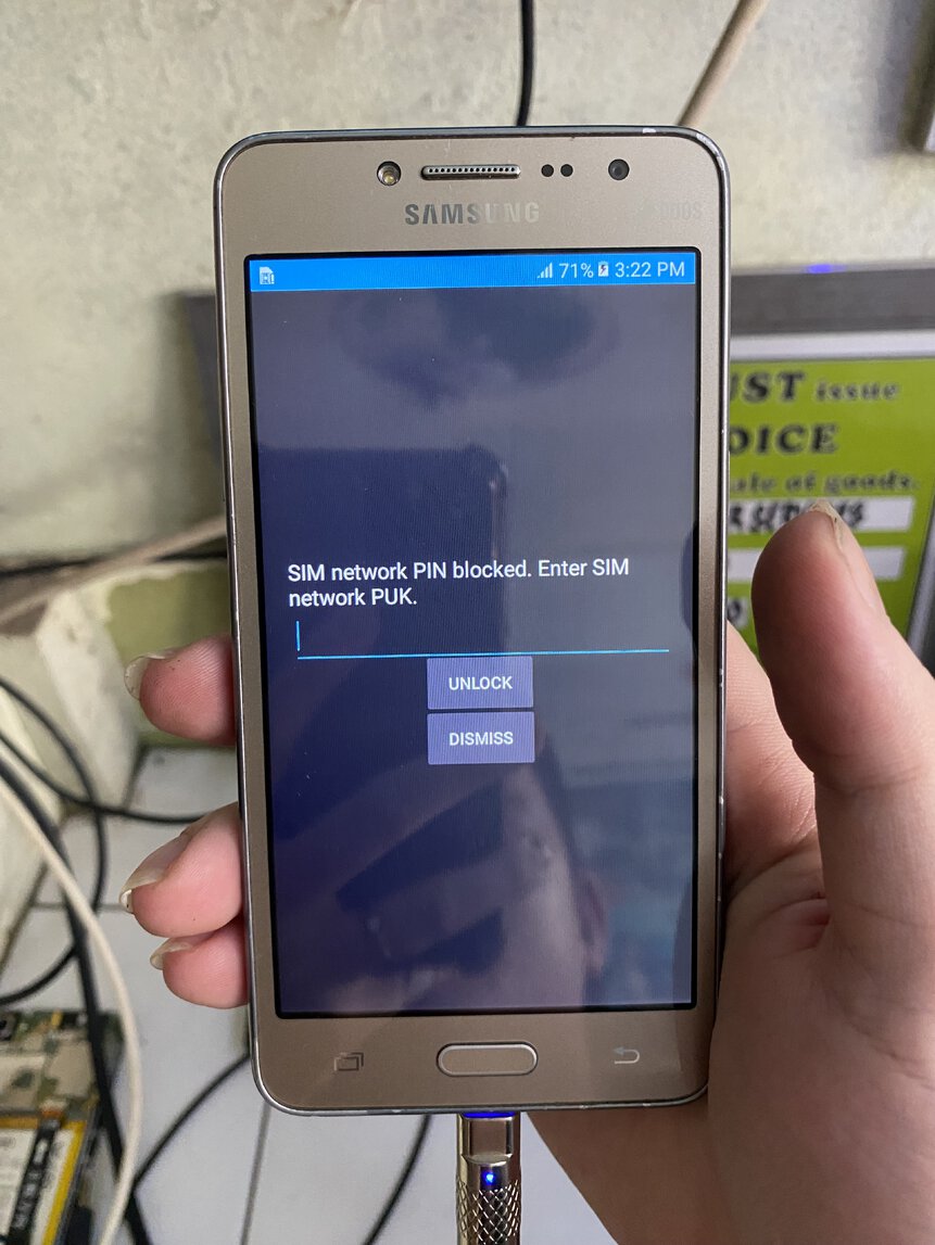

Samsung Galaxy J2 Prime SM-G532G
Problem:​
SIM Carrier Smart Locked

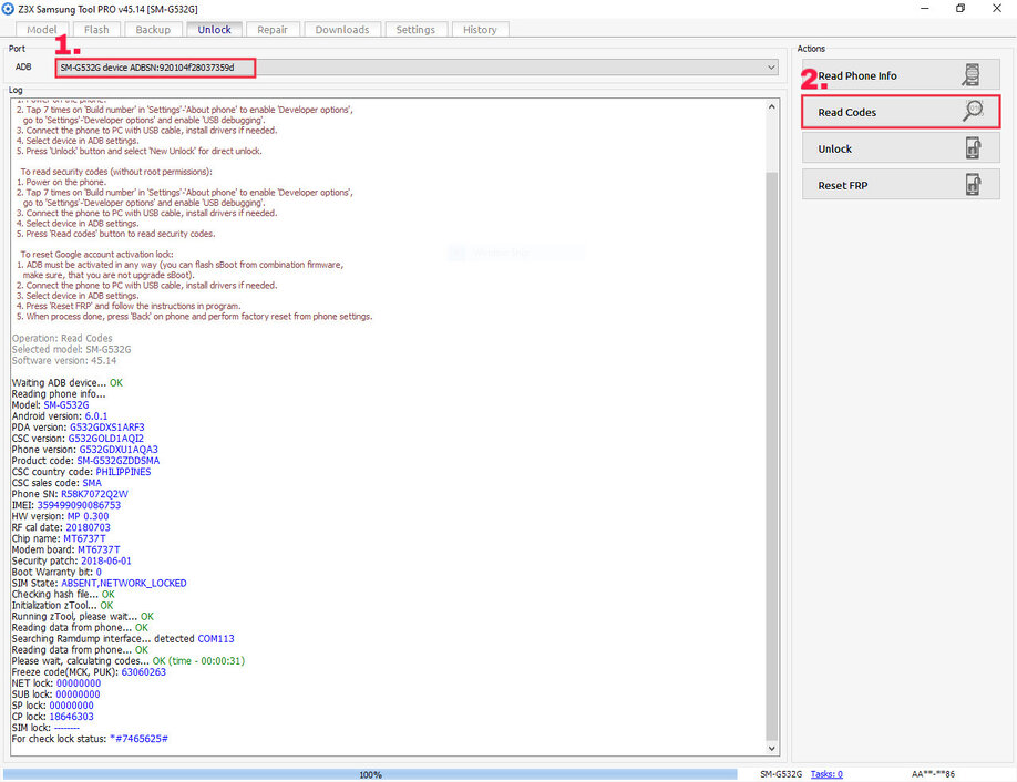

Used Tools:​
Z3X Box
Samsung Tool PRO v45.14 – Download – Mirror Link
Procedure:​
1. Enable USB Debugging sa Developer Options
2. Connect phone sa PC.
3. Connect Z3X Box sa PC.
4..Open Samsung Tool PRO
5. Select SM-G532G
6. Go to Unlock tab > Select Samsung ADB Device > Read Code.
Wait hanggang matapos. Magbibigay ng codes ang tool na gagamitin pang unlock.
Ang unang code na ilalagay ay Freeze Code at ang pangalawa naman ay CP lock.

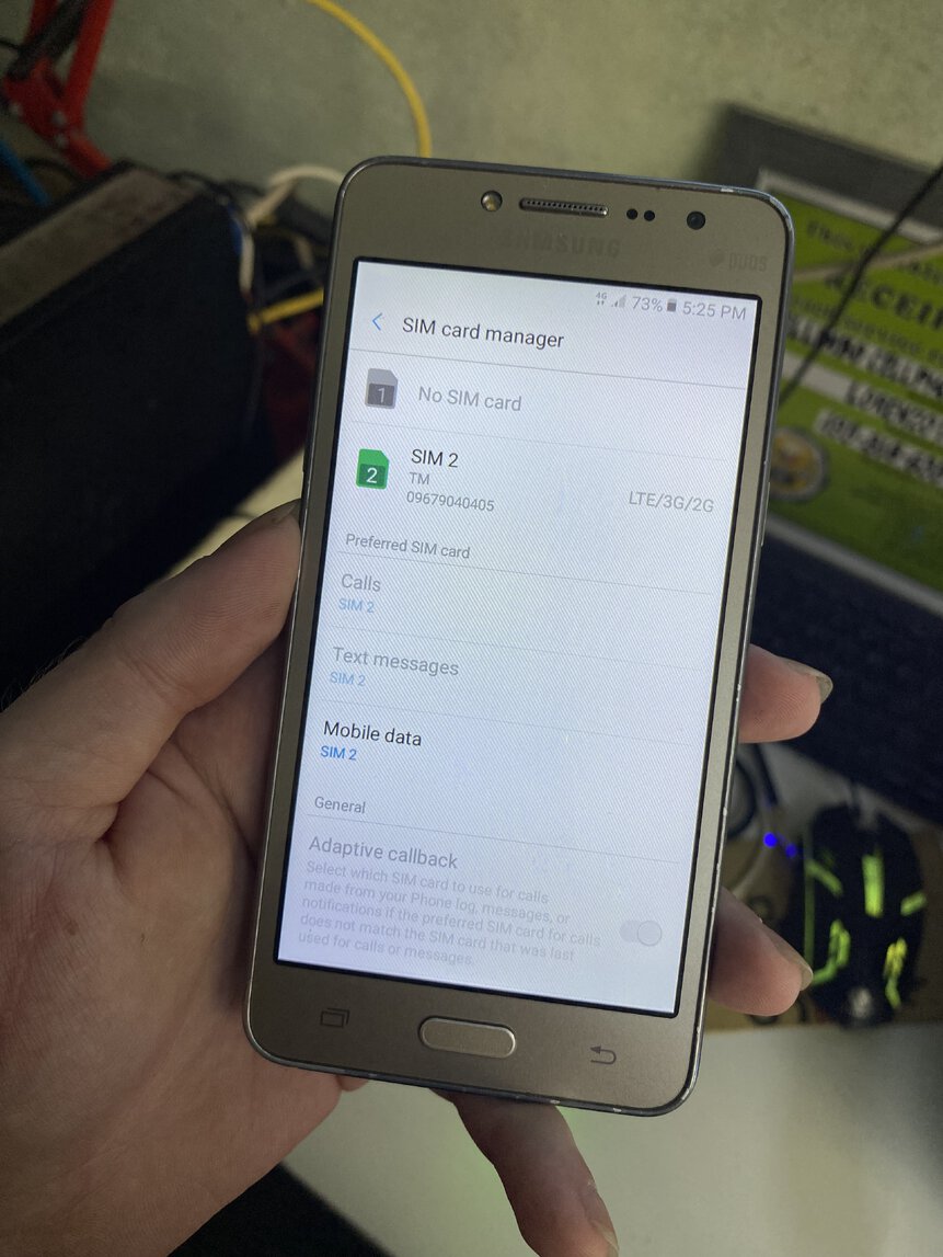

Kapag tama ang nailagay mong code ay may lalabas na Network Unlock Success.
Your SM-G532G is now network unlocked at gagana na sa kahit anong SIM!​

Procedure:​
5. Select SM-G532G
View attachment 27100​
