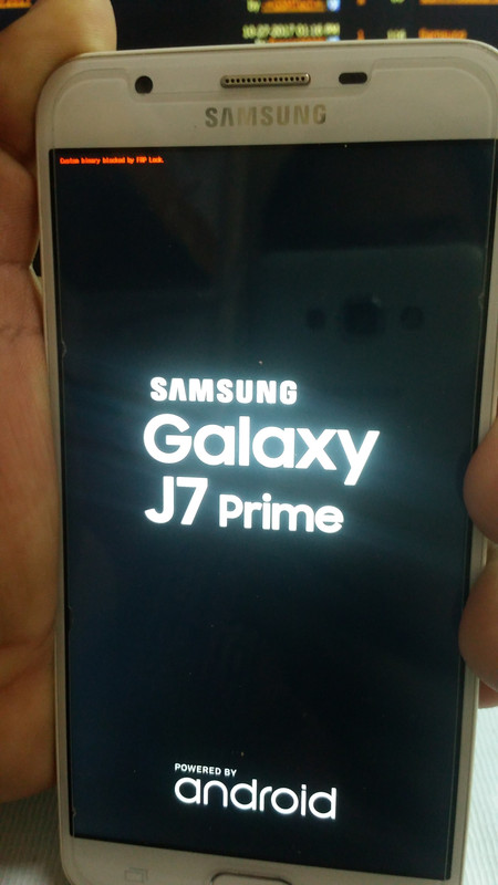

problem
Samsung Galaxy J7 Prime SM-G610F/DS Custom binary blocked by FRP

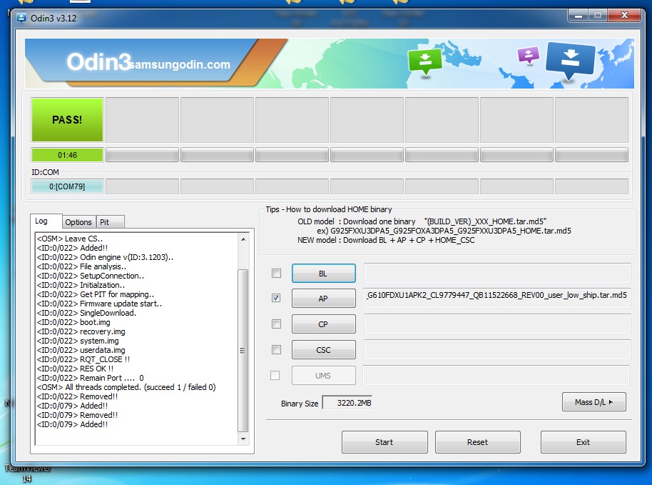

Flash po natin sa Odin AP Lng po ang ilagay ntin gaya ng nasa picture
At hintayin hanggang matapos
DONE..
Firmware credit po sa may ari slamat...
