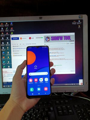

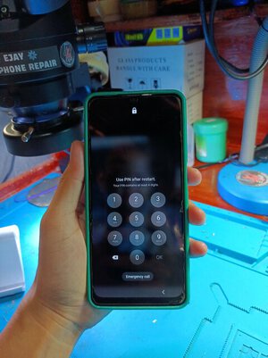

SAMSUNG GALAXY M12
DI MAKAPASOK SA RECOVERY MODE
BUTI NAG DOWNLOAD MODE SIKAPIN NIYO LANG MAPAPASOK SA DOWNLOAD MO KUNG AYAW SA RECOVERY MODE
DOWNLOAD THIS TOOL :
https://www.mediafire.com/file/wn5rtdrbs9q64s5/SamFw_Tool_v4.0.zip/file

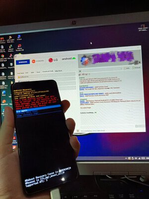

KUNG NAKA DOWNLOAD MODE NA
GO TO ODIN MODE TAB
FACTORY RESET
THEN WAIT LUMABAS RECOVERY MODE FACTORY RESET NIYO VIA RECOVERY LLABAS YAN NG KUSA WAIT NIYO LANG✅
IF NAFACTORY RESET NIYO NA FRP ISSUE NALANG SKIP NIYO NA YANG PART NA YAN
PARA SA FRP
DIAL SA EMERGENCY CALL
*#0*#
LALABAS TEST MODE
KUNG NASA TESTMODE NA OPEN SAMFW TOOL
CLICK TEST MODE TAB
CLICK REMOVE FRP
After loading
LALABAS ALLOW USB DEBUGGING
CHECK AND ACCEPT/CONFIRM
THEN WAIT UNTIL DONE ✅
ANDYAN NA LINK NG TOOL EXPLORE NALANG BASTA WORKING TESTMODE SA UNIT NA HAWAK MO MATIK YAN DONE YAN IN A SECONDS
