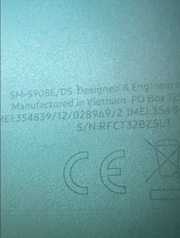

Unit: Samsung Galaxy S22 Ultra
Model: SM-S908E/DS
Problem: Google Account Remove (Android 13)

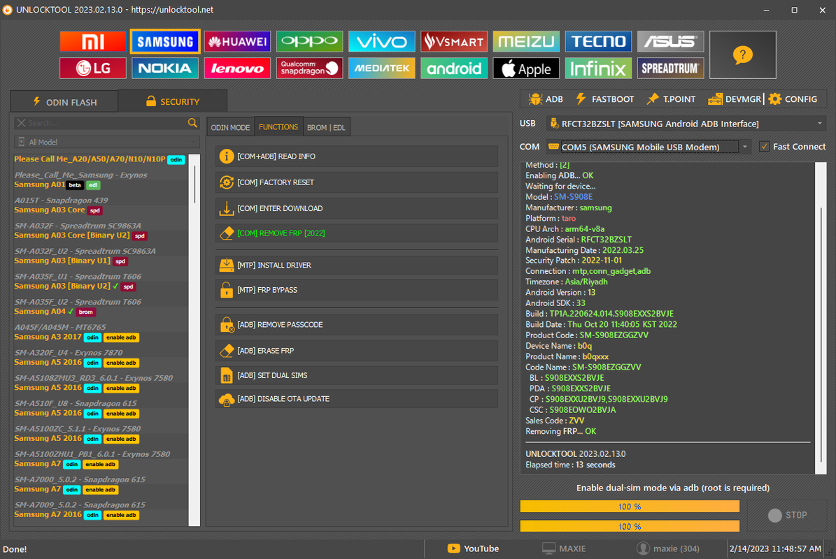

Solution
  1. Flash to this firmware S908EXXS2BVJE_OWO2BVJA
  2. Dial *#0*#
  3. unlock via unlock tool
  4. Click remove FRP 2022 and select the latest version
  5. if mag fails try again
Babala wag i flash sa android 12 version baka mag abuno po kayo
Images
Flashing Via ODIN
Unlock via unlock tools

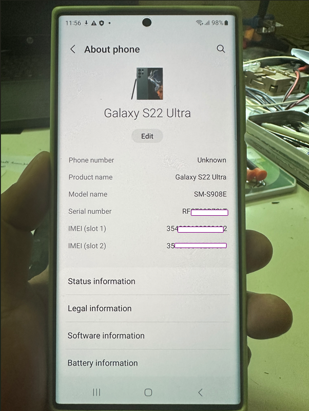

Result
