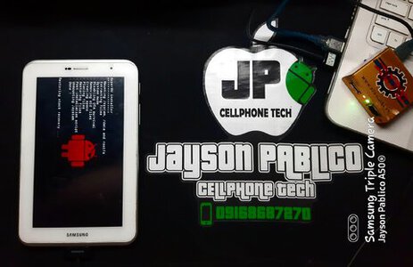

Step 2. Enter Download Mode Ssamsung Tab and Flash Root File.
Step 3. After Flash Root File Via Odin.

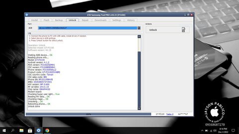

Step 4. Open Z3X Pro Box And Select Model : GT-P3100. And Click Unlock Tab.
Step 5. Insert USB Cable And Click Grant Acces Root.

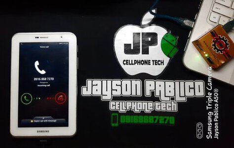

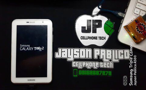

After Unlock Insert Sim Card And Try Calling.
My Works Done.
