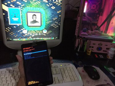

Procedure: HARD Reset lang
1. VOL DOWN to choose Data factory reset ..
2. factory reset lang po huwag na po esali si WIPE Partition;

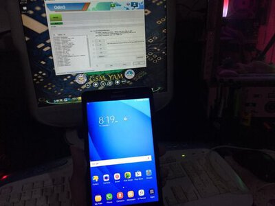

FRP Remove
1. Download ==> FRP TAB A
2. Download ==> odin3_v3.14.1
TAKE NOTE: after download the FRP TAB E FIRMWARE, Huwag nyo extract ang zip file;

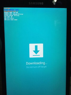

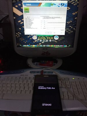

1st => OPEN Odin tools
2nd => click AP add the FRP TAB A firmware na nadownload ninyo,
3rd => press vol- down, home button, and power, para lumabas odin mode, press vol up again.
4rth; =>insert usb cable at pag na detect na hit the start , automatic magbubura nayan at kusang mag rereboot si tab,
DONE and FINISH...
FRP Remove
DONE and FINISH...
