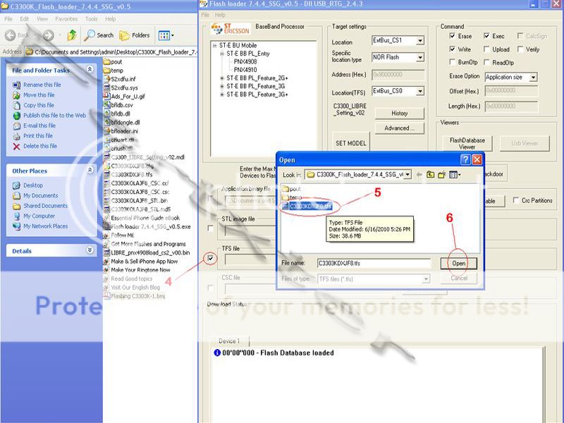

1. Run Flash loader 7.4.4_SSG_v0.5.exe

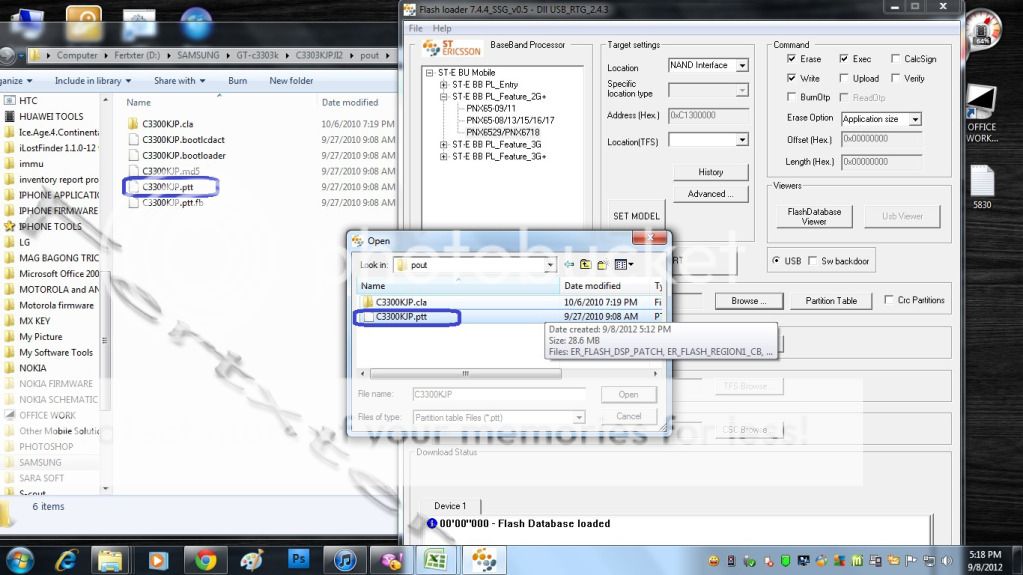

2. Click SET MODEL -> Select C3300_LIBRE_Setting_v02.mdl
3. Check Application binary file -> browse for C3300KJP.ptt (From the C3303KJPJI2 folder)
4. Check TFS File -> Browse for C3303KJPJI2.tfs
5. Check CSC File -> Browse for C3303KOJPJI1.csc
6. Click Start

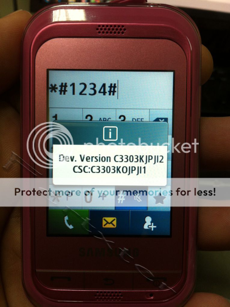

(During the Flashing, your phone is off, then when the flashing is finish, you can see the your phone is charging.
11. Remove from USB. Turn on the Phone,
My Finish Product
