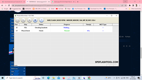

1. download ka muna firmware ito link>>> https://myhindidigital.com/samsung-gt-e1215-flash-file-flash-tool/
2. download karin ng research downloader ito link >>> https://www.mediafire.com/file/tvnrooy3fbbzj4b/SPD_Research_Tool_R2.9.7006.zip/file
Password: GT-E1215-officialroms
3.open research download select mo ang pac file
click mo start
4. ready mo ang cable at press mo ang ( OK ) button at salpak cable wait mo lang matapos done nayan
done!!
