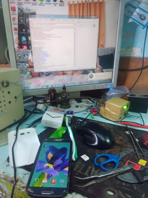

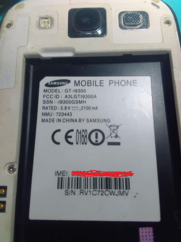

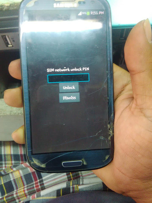

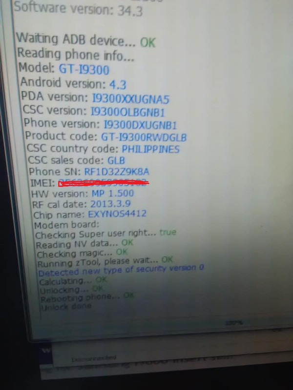

samsung GT-I9300 sim unlock done action taken go to developer on ang usb debug need root kaya root muna using kingo root para madetect ang adb after root buksan si z3x box select mo ang unit GT-I9300 den press unlock done note direct unlock ko sya dinali at nag success nmn
