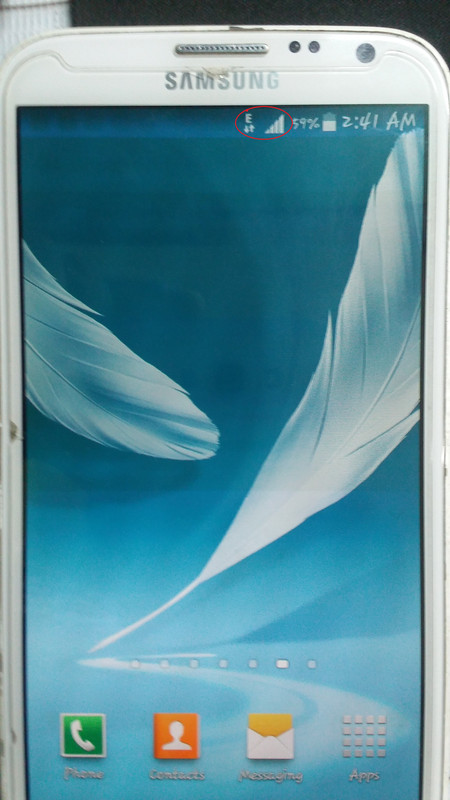

Ito siya
History ng phone ng restart lang daw at wala na ang signal
1st check ko baseband ok nman

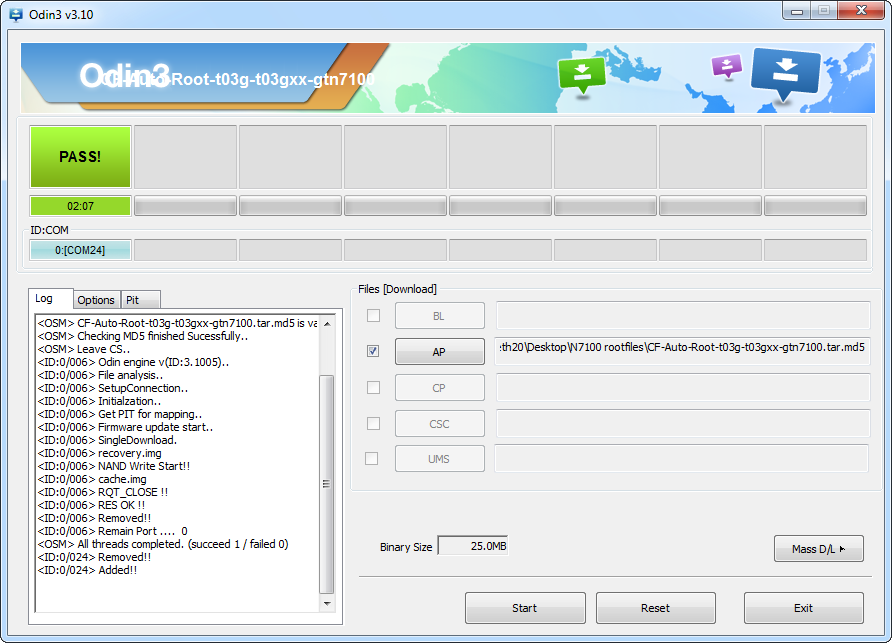

kaya open si odin at kailangan iroot ang phone ito nman gamit ko na pang root
https://download.chainfire.eu/264/CF-Root1/CF-Auto-Root-t03g-t03gxx-gtn7100.zip?retrieve_file=1
ito nman na siya after root

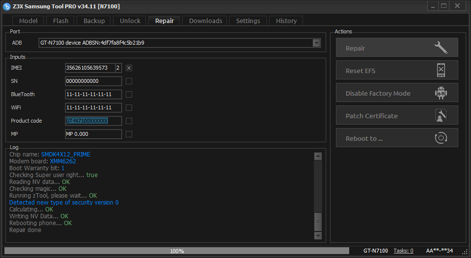

open z3x
Edit imei
click repair
click patch Certificate

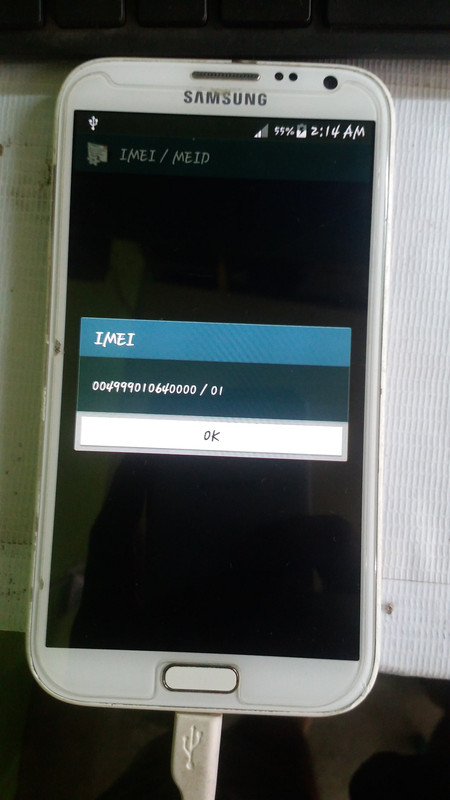

At done..
