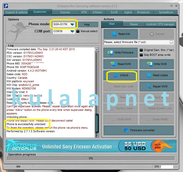

Direct Unlock by Octopus Box
Procedure:
1. Disconnect USB cable from phone.
2. Go to Menu->Settings->Developer options.
3. Turn on "USB Debugging" option.
4. When message is appear press "Yes".
5. Go to dial window.
6. Enter "*#7284#" number.
7. Set "UART" radio button to "MODEM" value.
8. Go to "Qualcomm USB Settings".
9. Select "DM+MODEM+ADB".
10. Press Home button.
11. Go to dial window.
12. Enter "*#9090#" number.
13. Select "DM/UM over HSIC".
14. Restart phone.
15. Press "Read Info" in software.
16. Press Unlock.
logs:
Platform: Samsung Android
Selected port: COM38
Selected model: SGH-I317M
Operation: Unlock
Reading info...
Mode: Normal
Firmware compiled date: Apr 18 2014
Firmware compiled time: 02:00:00
Firmware released date: Sep 3 2015
Firmware released time: 18:41:20
SW Version: M9615A-CEFWMAZM-2.0.14159
Please, press "OK" button on the phone to allow USB debugging.
Detected phone model: SGH-I317M
Firmware compiled date: Thu Sep 3 21:20:43 KST 2015
PDA version: I317MVLUDNH3
CSC version: I317MOYADNH3
SW version: I317MVLUDNH3
Phone IMEI: 355426kulaps
Phone SN: R38F70QEQAB
Android version: 4.4.2 (KOT49H)
Sales code: KDO
Country: Canada
HW platform: exynos4
HW Chip: smdk4x12_prime
HW Modem: MDM9215M
Warranty Void: 0

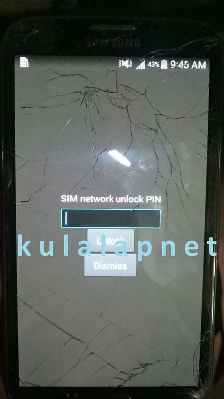

SIM 1 status: network locked
Codename: t0ltevl
Reading security backup, please wait...
Can't get superuser aceess. Please, repeat opperation once again and press "Allow" button on the phone every time when superuser dialog appears.
Unlocking phone...
Phone will restart now. Please don't disconnect cable!

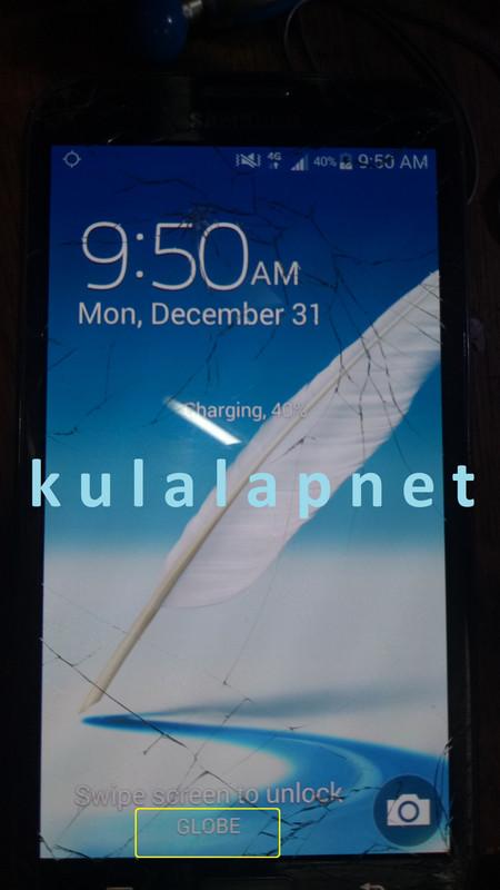

Phone is successfully unlocked
To finish the operation, please restart the phone via phone's menu.
Performed by 2.7.1.5 Software version.
