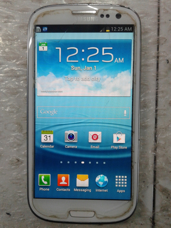

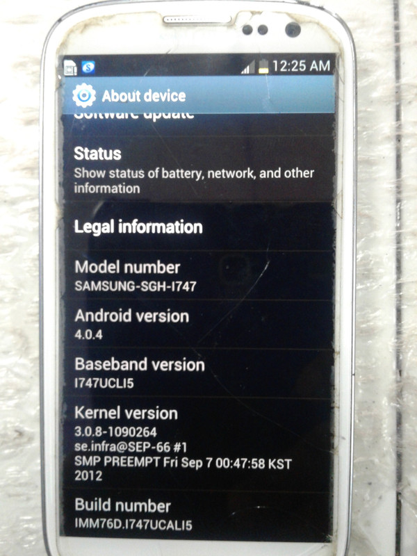

Samsung I747 pattern lock
first option hard reset
kaso di gumagana yung volume up

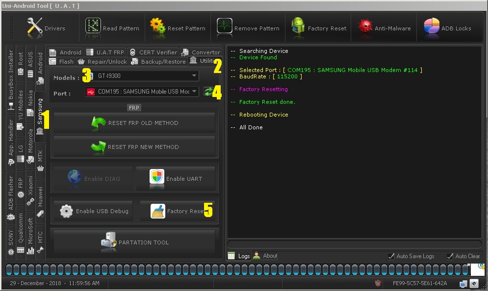

try ko sa UAT crack
piliin nyo lang na model I9300
1. open nyo po yung UAT Crack
2. Select nyo po "Samsung"
3.Select "Utilities" Tab
4. Select correct model (i9300)
5. Tick Port
6.Tick "Factory Reset"
done po
