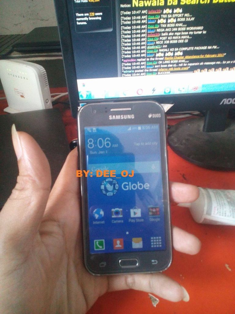

SAMSUNG J100ML/DS NA MAKUNAT,,DONE!!! 5-FILES FIRMWARE
PROBLEM:
-HANG ON LOGO

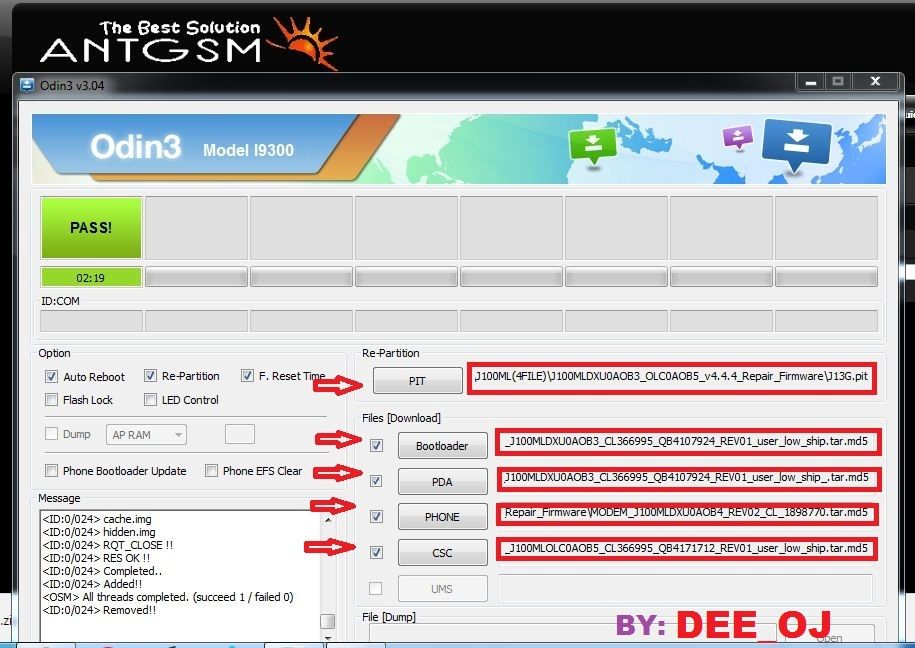

ACTION TAKEN:
-FLASH VIA ODIN
-(PRO NO LUCK KAHIT NKA 3 FIRMWARE NA AKO KASAMA NA YUNG TESTED KO..)
-SA THREAD NATO, http://www.antgsm.com/showthread.php?t=87661
-KAYA HANAP AKO KY UNCLE GOOGLE NG COMPLETE PACKAGE NA FIRMWARE
HINDI NMN AKO NABIGO.
-ITO YUN NA UPLOAD KO NA:
https://www.4shared.com/rar/a6uYiqnfce/J100ML-DS-_5-FILES__TESTED_BY_.html?
DONE!!!!

boss na try ko na po.,bakit yong sa akin deadboot na.,kahit download mode wala na,.
help po dito boss,.,,.

negative sa akin boss, nag hang ang unit ngayon dido na
