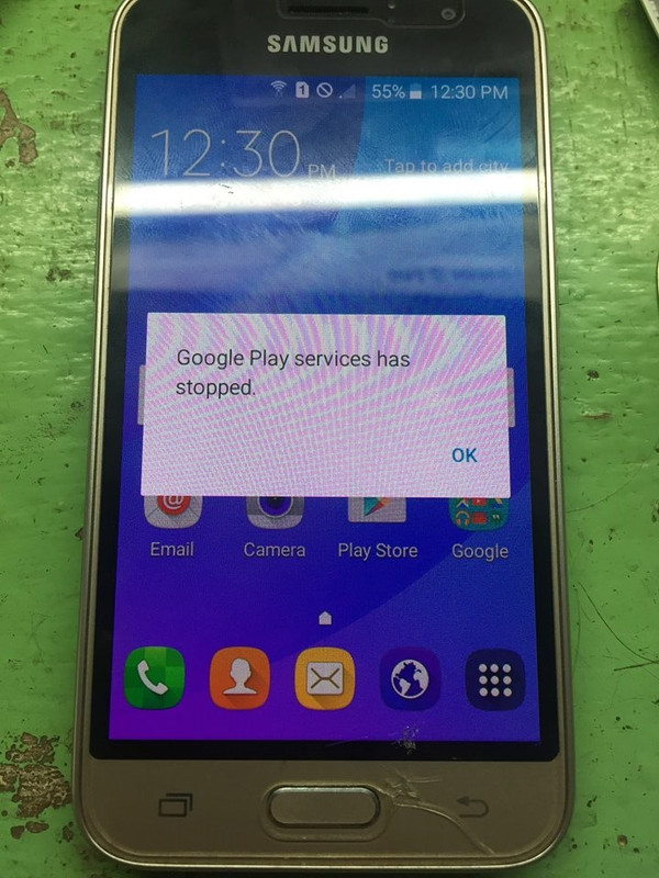

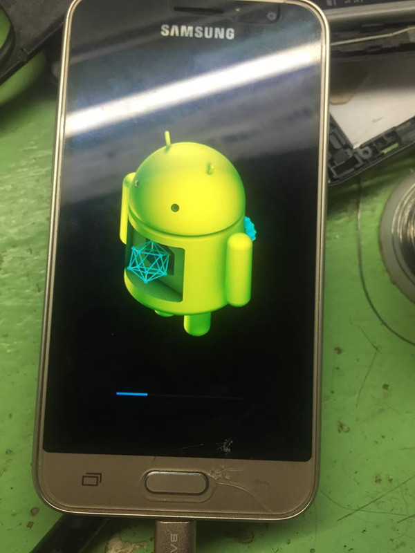

model: samsung J120H/DS
issue:google play service stopped
ito po siya

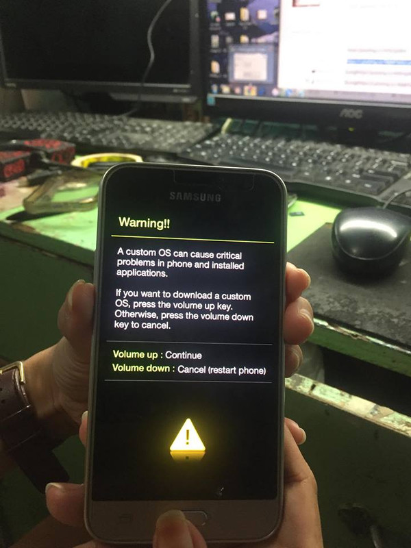

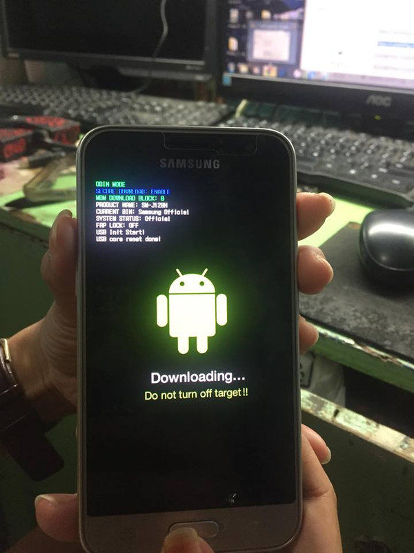

Procedure:
press volume down,power and home button to download mode

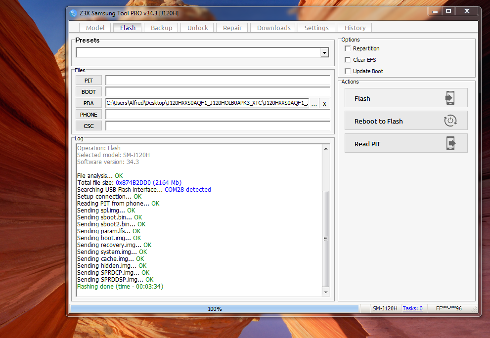

open the Z3X Samsung Tool PRO V34.3
download this tested firmware
https://www.sammobile.com/firmwares/galaxy-j1-/SM-J120H/XTC/download/J120HXXS0AQF1/177594/
Ito po ang logs

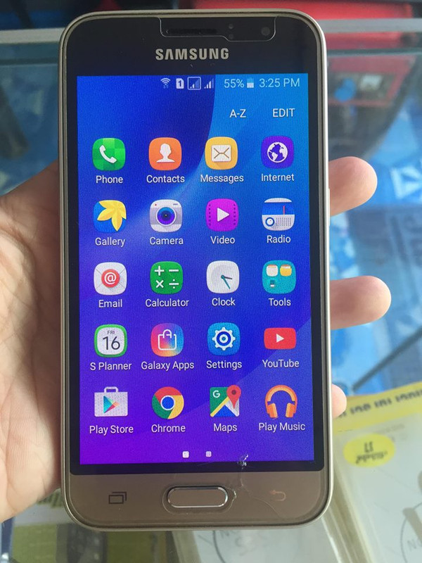

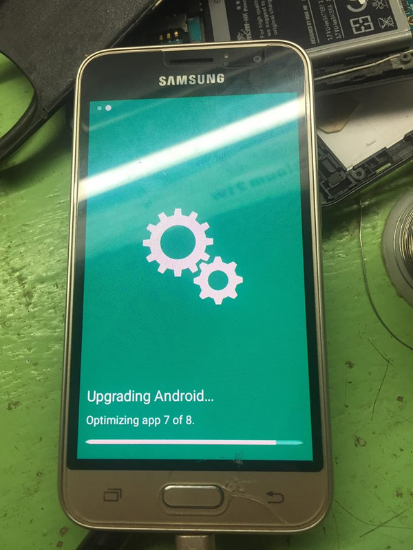

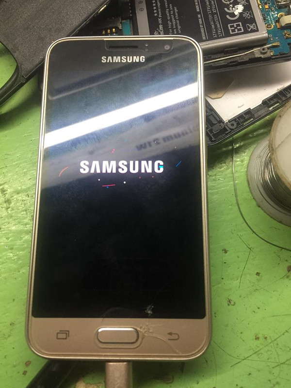

Ito na po ang finish product
thanks and more power
