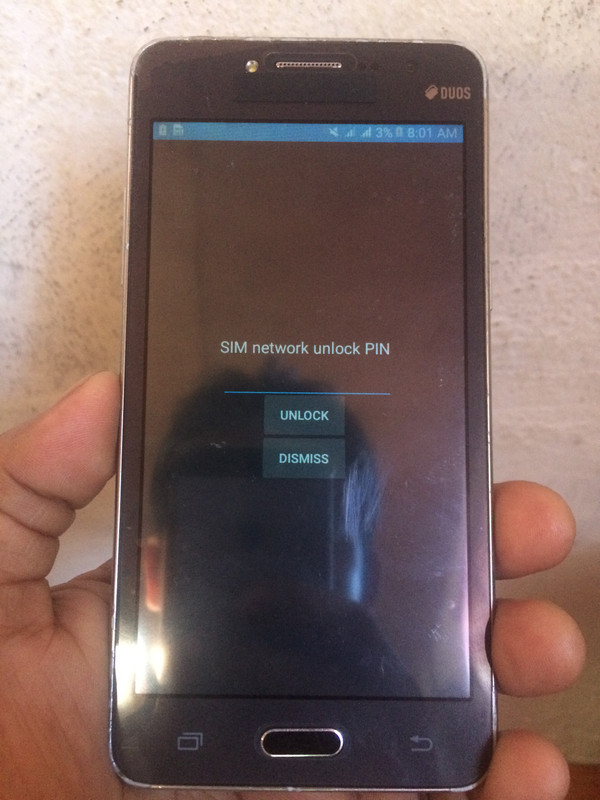

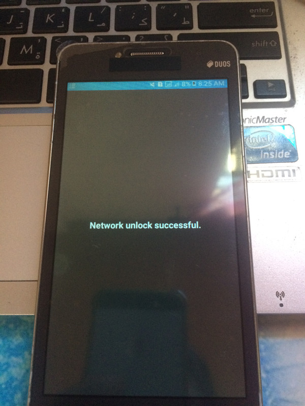

SAMSUNG J2 PRIME G532g GLOBE UNLOCK Z3X

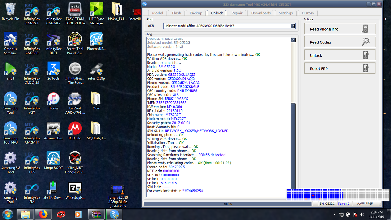

READ CODES ONLY
NO ROOT NEEDED
JUST ENABLE ADB
OPEN Z3X PRO
SELECT G532g
GO TO UNLOCK
TICK PORT ADB SELECT THE PHONE

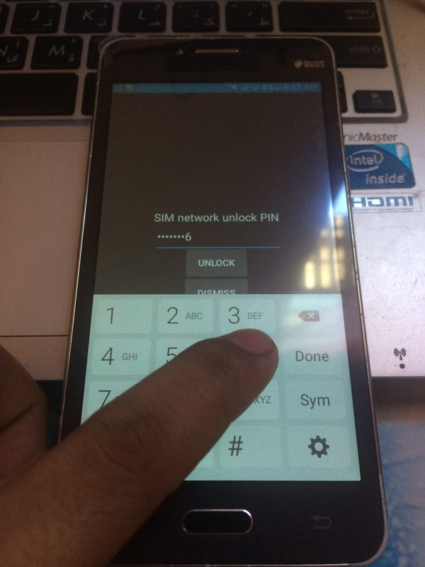

SELECT READ CODES

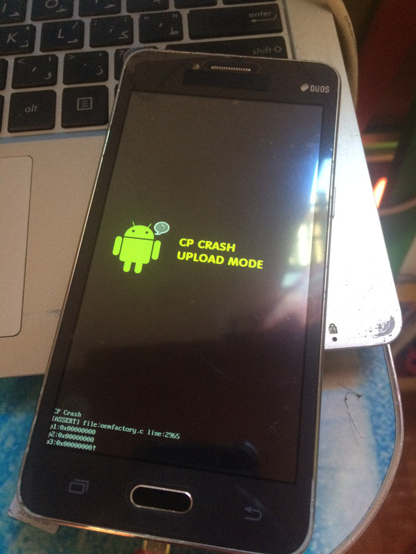

HAYAAN LANG PAG LUMABAS YAN DONT PANIC

Kailangan pa ba i-enter manually yung CP unlock code sir? hindi sya direct na ma-unlock?
