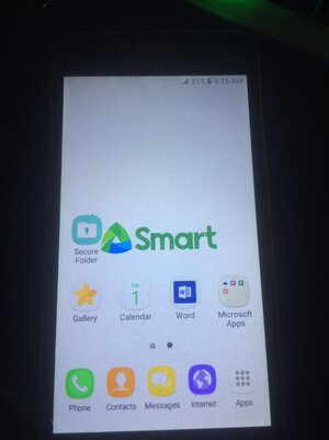

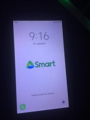

Procedure:
try sa tricks using*#272*IMEI sawi locked pa rin
UNLOCK INSTRUCTIONS:
1. Power on the phone.
2. Type *#0808# and select 'DM+MODEM+ADB'.
3. Type *#9090# and select 'DM/DUN over HSIC'.
Or use 'Activate Diag' function from 'Repair' tab.
4. Connect the phone to PC with USB cable, install drivers if needed.
5. Select diagnostic port in port settings.
6. Press 'Unlock' button for direct unlock.
Yan po finish product Salamat God bless us all
