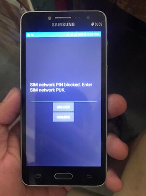

share ko lang mga idol

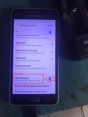

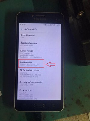

step 2 open settings
step 3 pindutin mo lang build number para lumabas developer options
step 4 click usb debuging

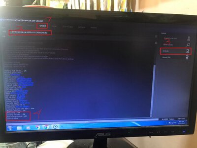

step 5 open z3x
step 6 click model
step 7 unlock
step 8 salpak usb cable wait mo madetect adb
step 9 click unlock

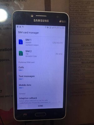

wait until done
sana po makatulong
