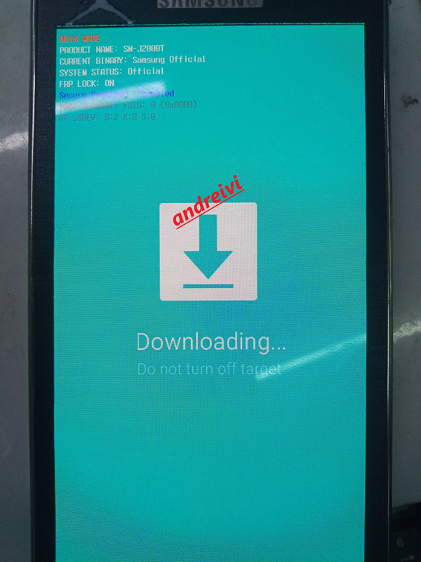

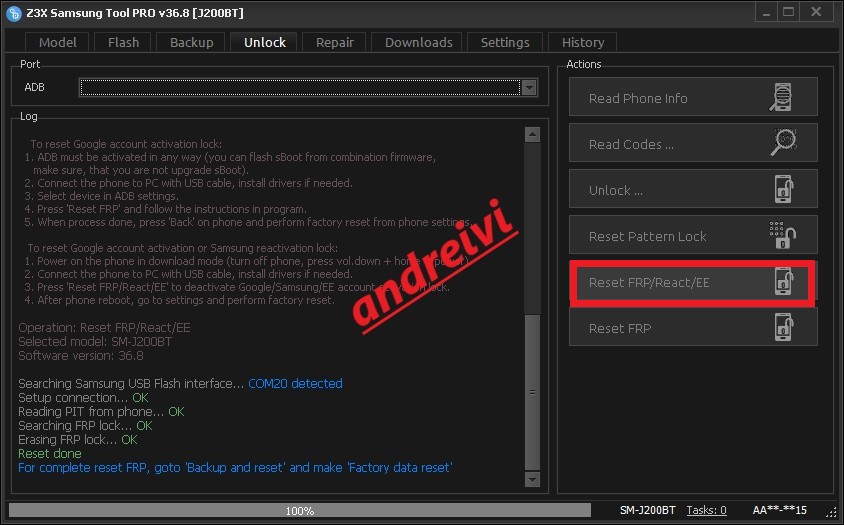

andreivi Registered Joined Jul 30, 2014 Messages 1,986 Reaction score 271 Points 381 Location Sison, Pangasinan/ Rosario, La Union Aug 13, 2019 #1 for reference lang Samsung J200bt may google account (FRP) done sa Z3xpro put phone in Download Mode Volume down + Home + Power Button connect phone sa usb open z3xpro select correct model select unlock tab click reset frp/react/ee done na po yung unit
