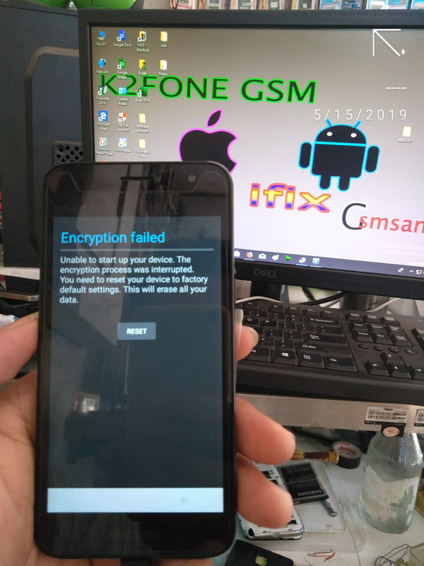

Di ko na picturan ng naka hang sa dl mode pa
History:
Inapdate ni tumer ang sofware update ng wala namn siya internet yung restating na
Action Taken :
Try ko hard reset hangang installing update sa 28 percent lang at mag error

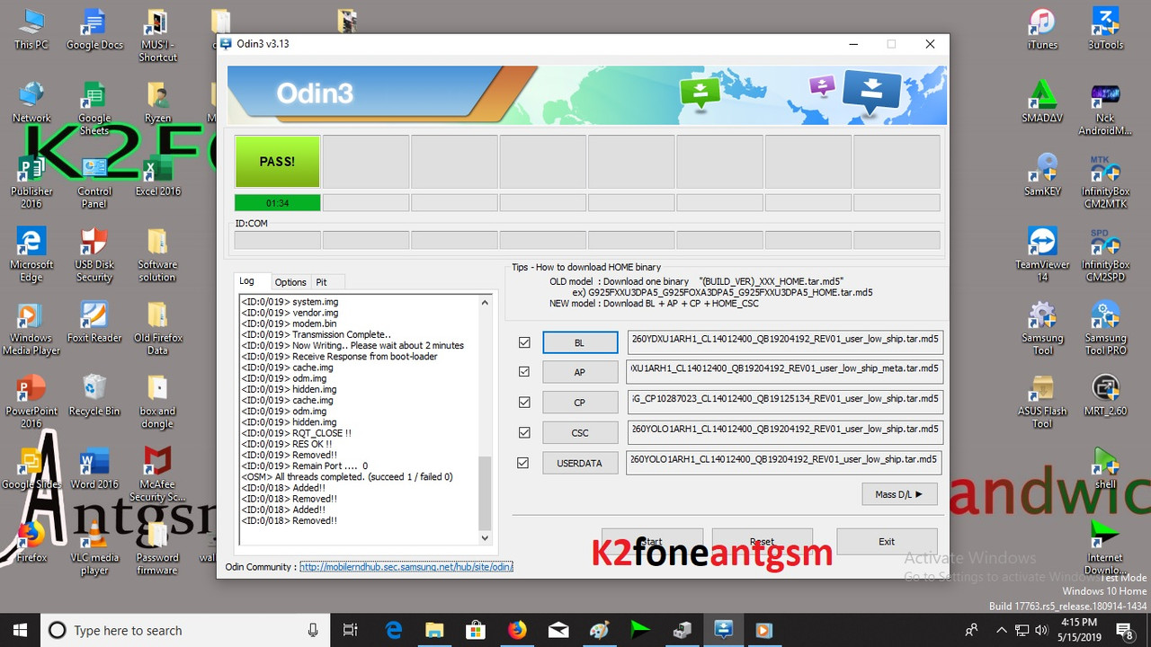

Kaya prucede sa flashing :
Ito ang fw:
https://drive.google.com/uc?export=download&confirm=fnWE&id=1a42X2qeCQHQxHrUL_snwnXPjbRb0Wqo6Flashtool odin:
https://drive.google.com/file/d/1awI-XMmvHhEnUtMQ39ZJO0zC8tmpeMSH/view
tapos may lalabas na ganyan alm na kung paano

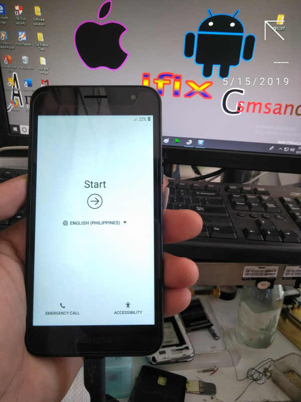

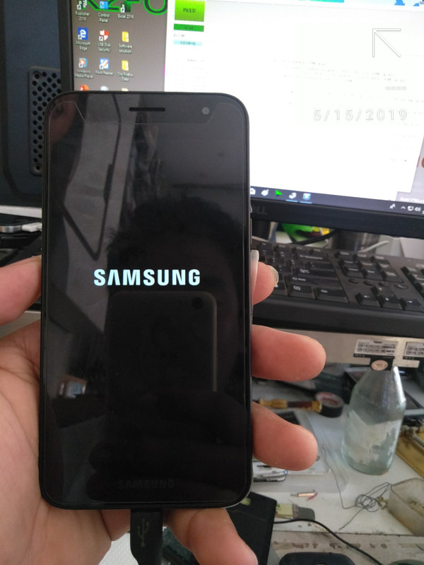

Done na
patunay.
