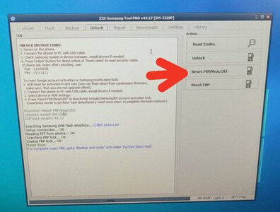

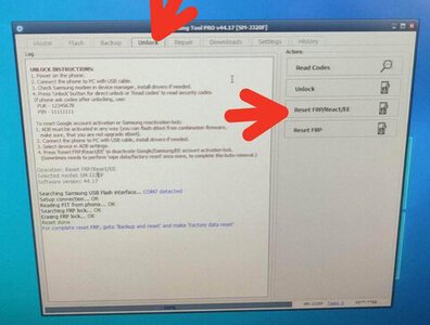

select correct model number in z3x tool pro Tab
then do Download mode ur J3 vol down & power button in second lng lumabas na yung DL mode put the USB cable
make sure normally detected ang unit, wag terahin pag sera ang charging pin baka dyan mag simula ang problima
old na ang J3 2016 kailangan maingat tayo sa mga unit na old.
then go to unlock tab then proced to Reset FRP/React/EE dirrectly frp removed.
