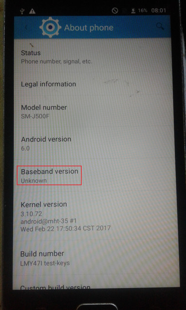

samsung j5 2016 clone no simcard
action taken:
lagay ng bagong sim(ganon parin)
check phone settings(UNKNOWN BASEBAND)

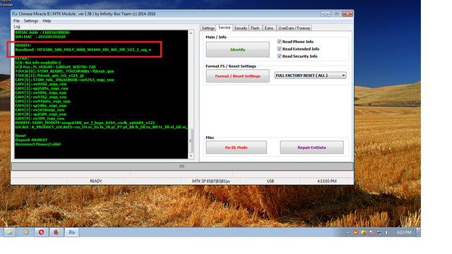

kaya open ko si cm2 mtk
and check info
when to drop comprehensive and collision
ayan complito pa ang baseband nya

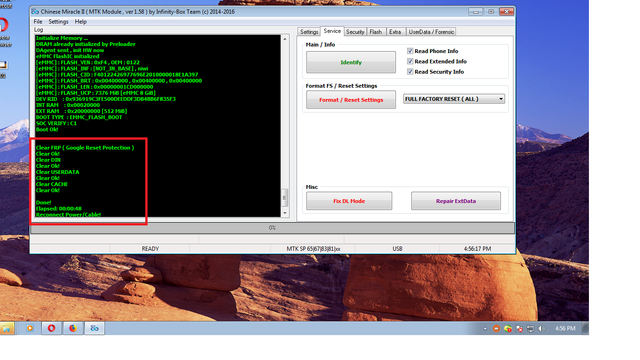

kaya back up ko muna
then proceed sa format
and done

action taken:
and check info

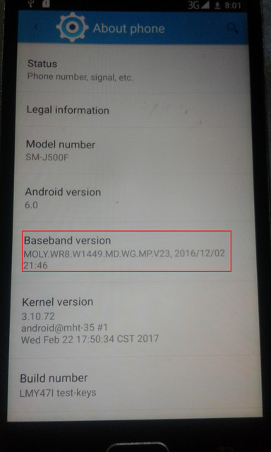

and done
