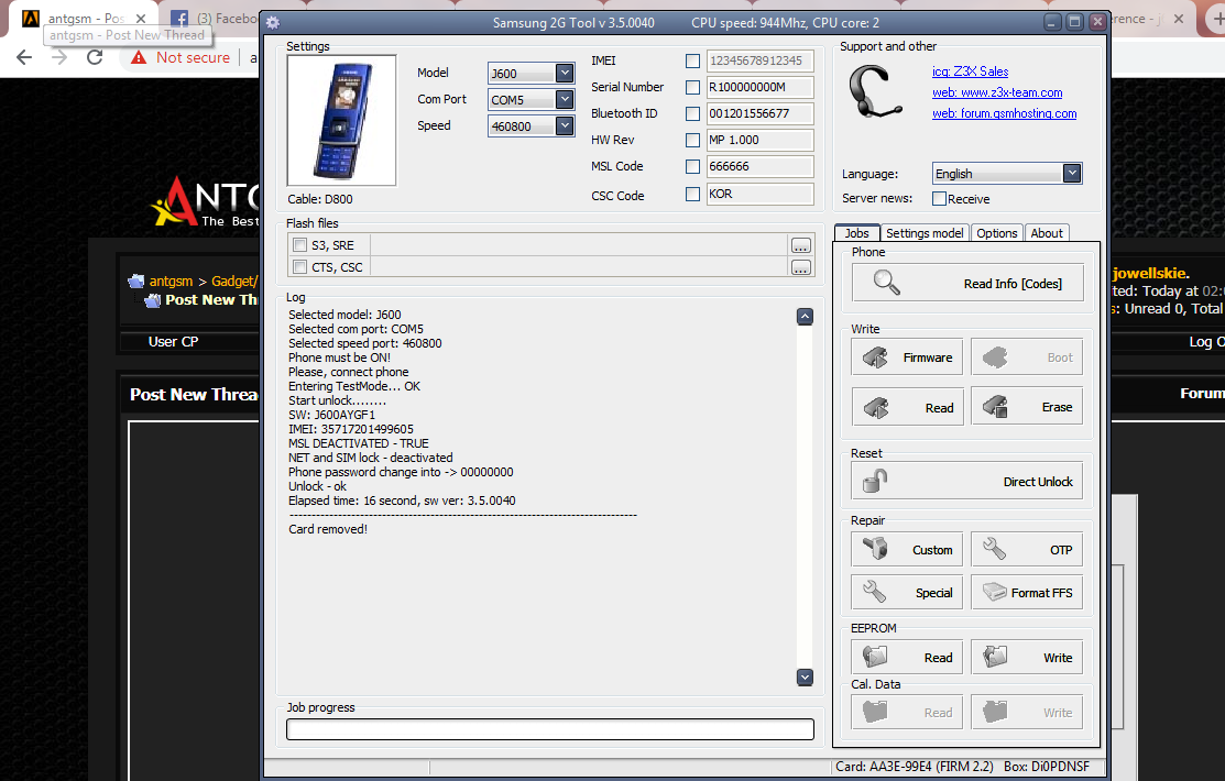

share ko lng old samsung j600 unlock
old but gold ayus....
procedure
1. open z3x
2. select model j600
3. power on the phone
4. click direct unlock
5. insert rj45cable d800
Code:
log
Selected model: J600
Selected com port: COM5
Selected speed port: 460800
Phone must be ON!
Please, connect phone
Entering TestMode... OK
Start unlock........
SW: J600AYGF1
IMEI: 35717201499605
MSL DEACTIVATED - TRUE
NET and SIM lock - deactivated
Phone password change into -> 00000000
Unlock - ok
Elapsed time: 16 second, sw ver: 3.5.0040
