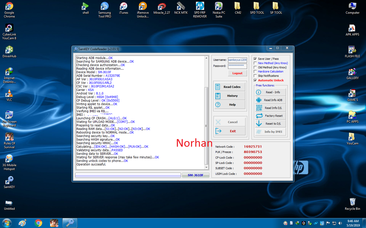

Share Kolang gawa ko
Unit : j610f
Staus : Lock to all network
Procedure : Read Code Via Samkey - 3credit
- Open USB debuging & OEM Unlocking
- Dial *#0808# Set DM+MODDEM+ADB
- Saksak Usb s pc
- Click Read Code sa Samkey Soft
- at hitayin matapos
- At wag kalimutan i install muna ang driver ng samkey bago ang lahat
Screen Shot
Salamat sana maka tulong​
