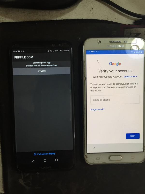

New Trick for samsung but not limited to J7 only
Problem FRP...
complicated since
walang access sa emergency call
walang permission access sa google assistant
negative sa talk back tricks
and most of all sira USB port - di madetect saklap huhuhu
insert sim card sa unit na me FRP and connect to wifi
use another android unit na me sim with load (kasi gagamitin natin pang call)

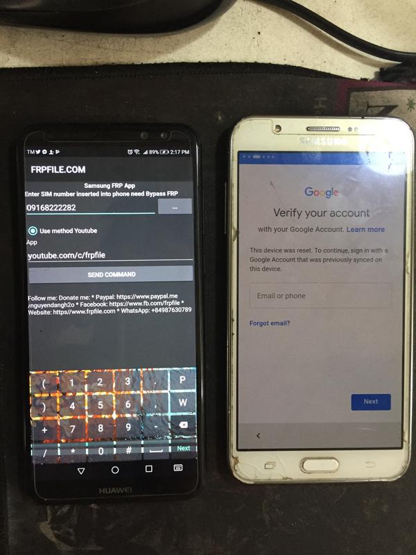

browse to https://frpfile.com/bypass/
download and install FrpAllSamsung.apk

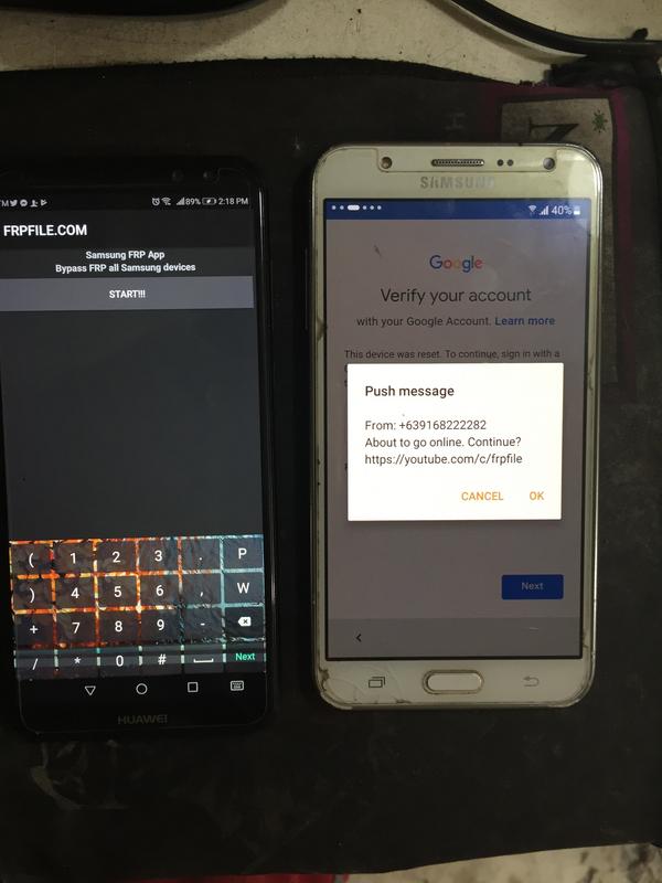

open the app .. type in yung number ng sim sa FRP locked na unit

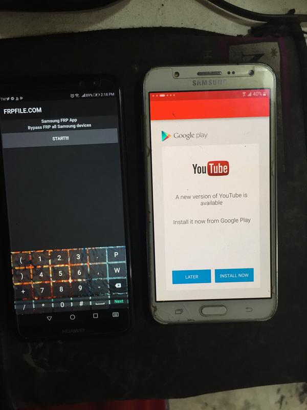

tick SEND COMMAND
voila me access ka na sa youtube sa FRP locke unit

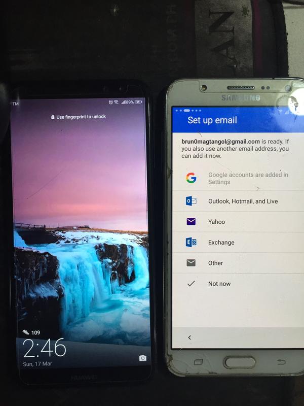

go to goole chrome browser and punta ka uli sa https://frpfile.com/bypass
for me install ako ng APX launcher then Google Account Manager
and the rest,, is common sense
