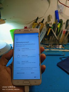

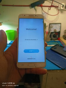

Frp remove via Unlock Tool
PROCEDURE:
1. OPEN UNLOCK TOOL.
2. SELECT SAMSUNG SECTION.
3. GO TO FUNCTION TAB.
4. SELECT (COM) REMOVE FRP 2020

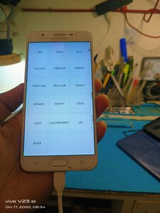

5. TYPE *#0*# ON EMERGENCY
6. SELECT CONTINUE METHOD OLD.
7. CLICK ALLOW SA PHONE SCREEN LILITAW YAN. FOR ADB CONNECTION

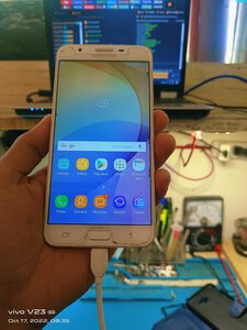

8. WAIT UNTIL DONE.
