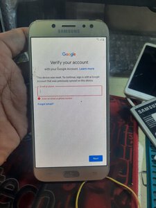

history . ....ni reset nya pero nakalimotan nya yong gmail nya.

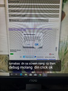

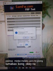

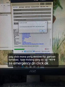

action taken..... open samFw tool. click remove frp. salpak cable .
noted. naka andar lang yong cp. sundan molang guide.

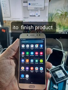

done sa.akin tnx.
