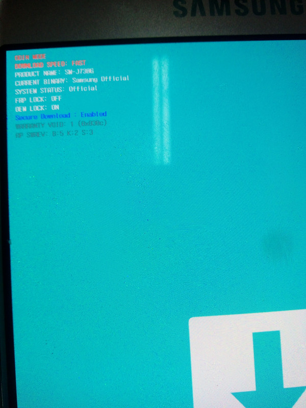

INSIDE MIRACLE CLICK SAMSUNG CLICK REACTIVATE/EE
SCAN KA MUNA PARA MA BASA ANG SAMSUNG MODEM
START MLNG
AFTER MA ALL DONE SA MIRACLE MAG SSTAY NLNG YANG WHITE LINE SA DONWLOAD MODE NG SAMSUNG

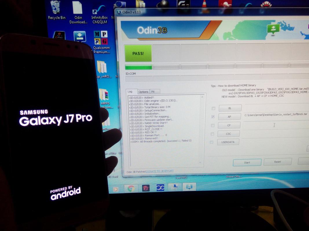

VOLUME UP+HOME+POWER
DONWLOAD MODE ULIT

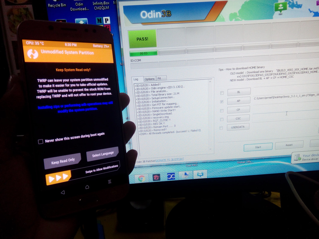

fix natin si oem missing
ito
https://123link.pw/Khhh1z
4

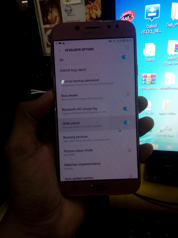

KAPAG OFF NA ANG OEM UNLOCK
READY NA SYA FLAH SA TWRP

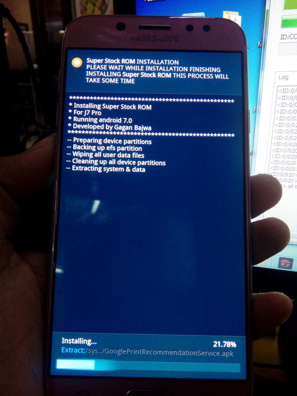

PARA MA DOWNGRADE NA NTIN SI J7 PRO
GAMIT PARA SA DOWNGRADE
USB OR MICRO SD
KC SAKIN GAMIT KO USB GINAMITAN KLNG NG OTG PASOG NMAN
http://www.mediafire.com/file/4r7vogeyobgyj3g/J7+Pro+Touch+Fix+Files.7z
PAG NAG SUCCEC NA ANG PAG DOWNGRADE
BOOM!!
