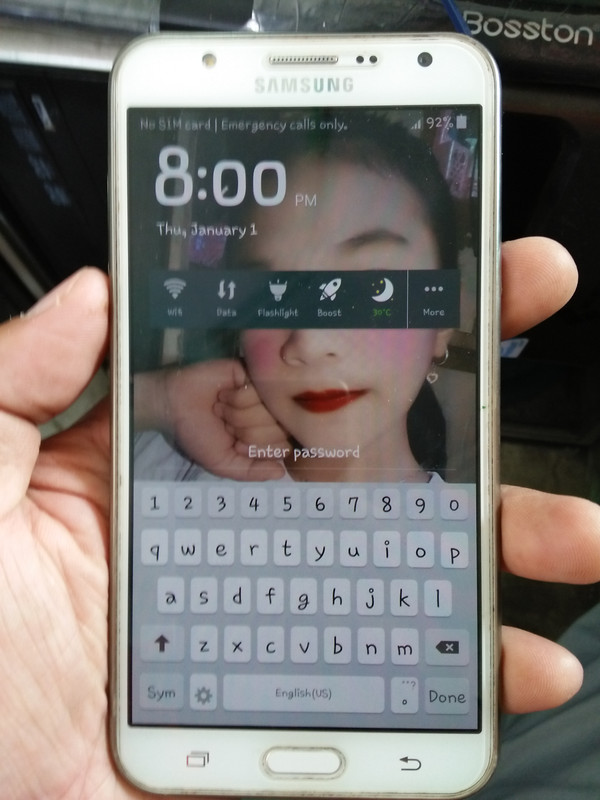

PROBLEM:

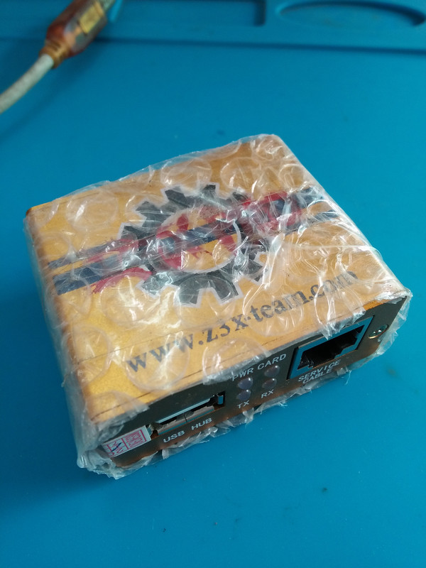

TOOLS:
Samsung Tool Pro V34.8: CLICK HERE

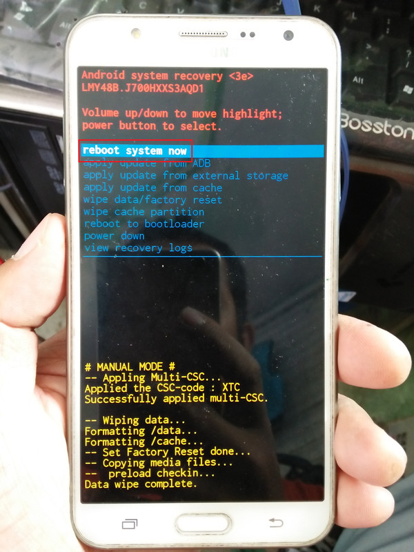

PROCEDURE:

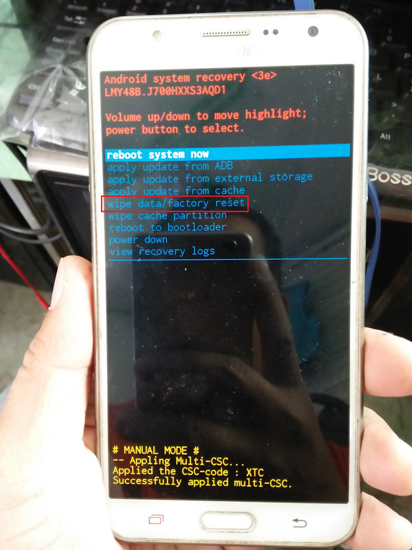

* Hard Reset by pressing VOLUME Up + HOME BUTTON + POWER BUTTON
* Select WIPE DATA/FACTORY RESET

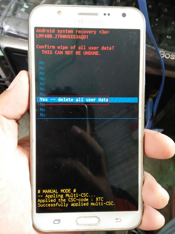

* Select YES--DELETE ALL USER DATA
* Then REBOOT SYSTEM NOW

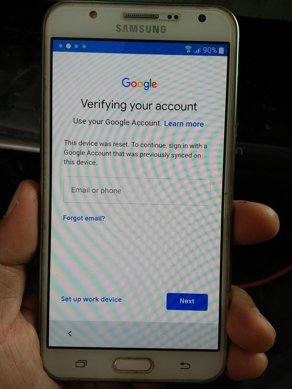

DONE Proceed to FRP Lock

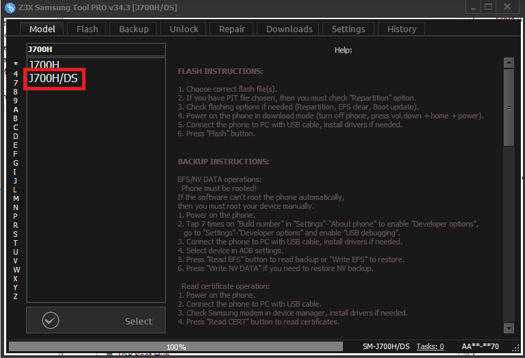

* Open Samsung Tool Pro Select Model J700H/DS
* Enter DOWNLOAD MODE by pressing VOLUME DOWN + HOME BUUTON + POWER KEY
* Click UNLOCK tab, then click RESET FRP/REACT/EE and your DONE
DONE
