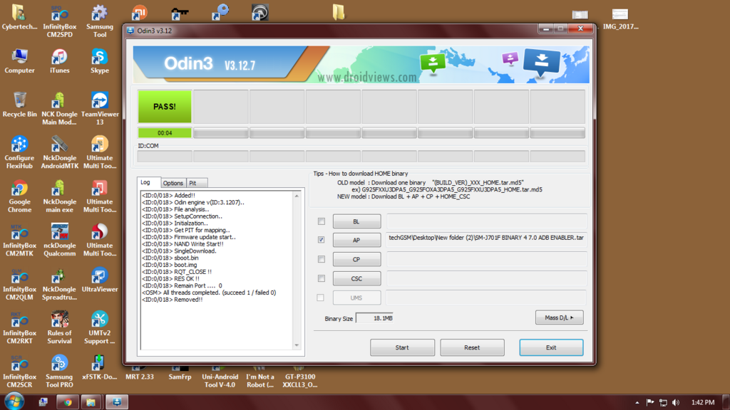

Procedure
Open Odin Then Load Adb Enabler

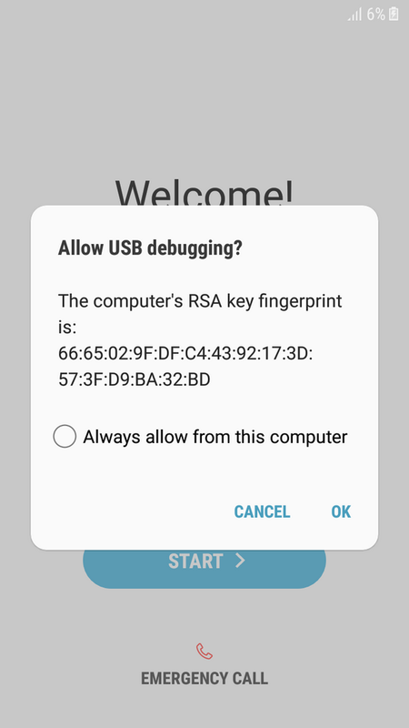

After Flashing Adb is ON
Now Perform Wipe Frp via ADB in Z3x or Any ADB WIPER FRP
> Connecting Device OK
Device is connected on ADB

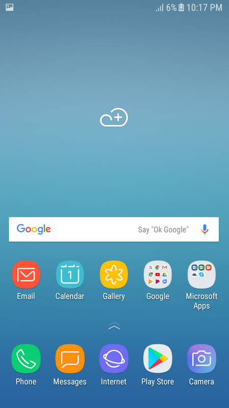

Result
After WIPE (Perform Factory Reset in Setting or Flash Again in Stock Rom for BEST RESULT)
