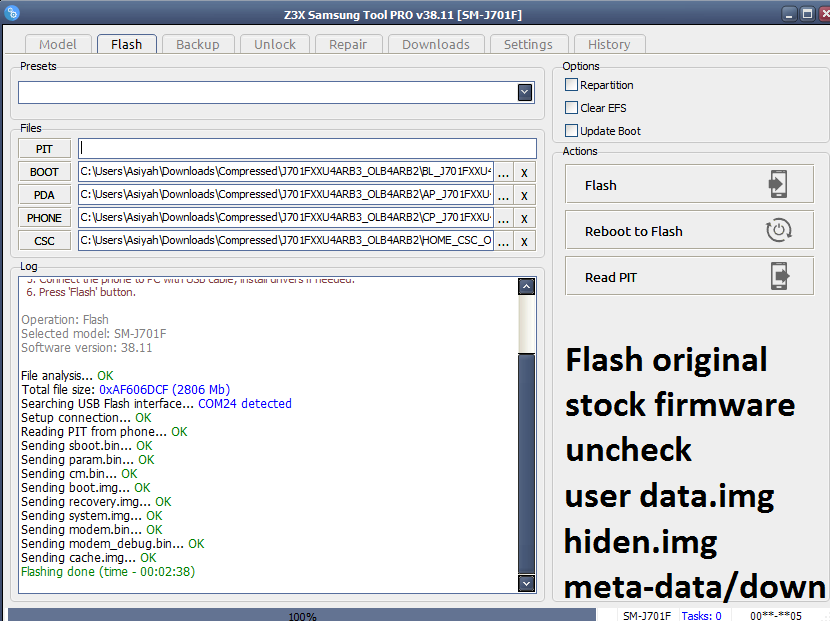

DL COMBI same bainary U4 Flash z3x

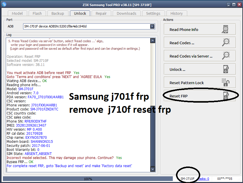

after flash combi adb mode select model j710f reset frp

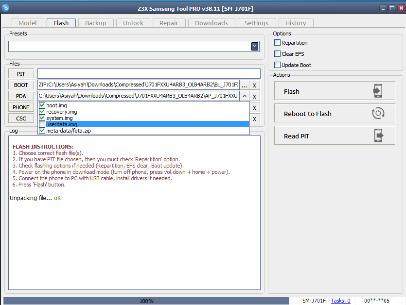

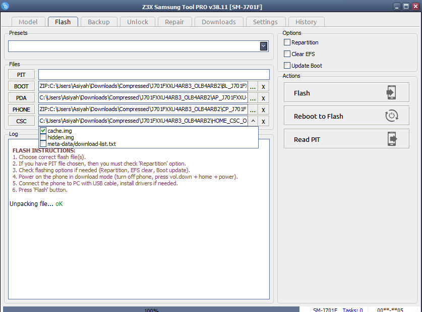

flash original stock rom model j701f (uncheck PDA userdata.img, CSC hidden.img,meta-data/download-list.txt)
