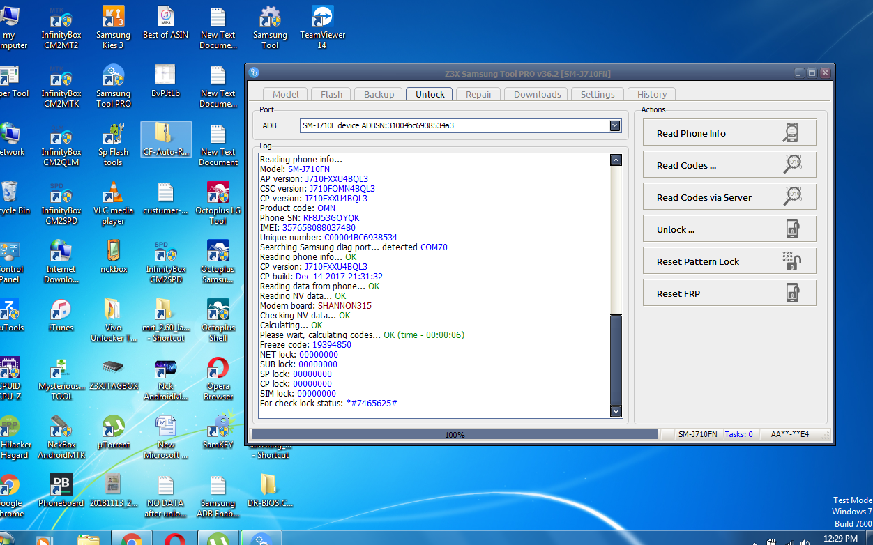

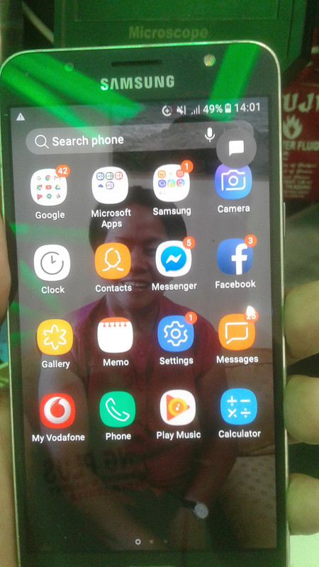

samsung j710fn from italy lock sa vodafone done via z3xbox
tools
technician ahihi
z3xbox
loptop
usbcable
procedure
1. Power on the phone.
2. Type *#0808# and select 'DM+MODEM+ADB'.
3. Connect the phone to PC with USB cable, install drivers if needed.
4. Press 'Read CERT DIAG' button to read certificates.
(Note, that the cert file for this model is unique. You can write cert, wich is readed from this device exactly.)
screenshot
logs..
Operation: Read Codes
Selected model: SM-J710FN
Software version: 36.2
Checking hash file... OK
Searching Samsung modem... detected COM72
Reading phone info...
Model: SM-J710FN
AP version: J710FXXU4BQL3
CSC version: J710FOMN4BQL3
CP version: J710FXXU4BQL3
Product code: OMN
Phone SN: RF8J53GQYQK
IMEI: 357658088037480
Unique number: C00004BC6938534
Searching Samsung diag port... detected COM70
Reading phone info... OK
CP build: Dec 14 2017 21:31:32
Reading data from phone... OK
Reading NV data... OK
Modem board: SHANNON315
Checking NV data... OK
Calculating... OK
Please wait, calculating codes... OK (time - 00:00:06)
Freeze code: 19394850
NET lock: 00000000
SUB lock: 00000000
SP lock: 00000000
CP lock: 00000000
SIM lock: 00000000
For check lock status: *#7465625#
ayus....
