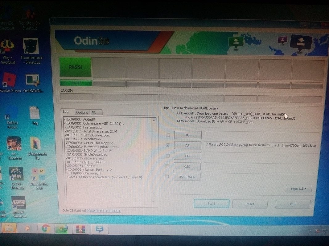

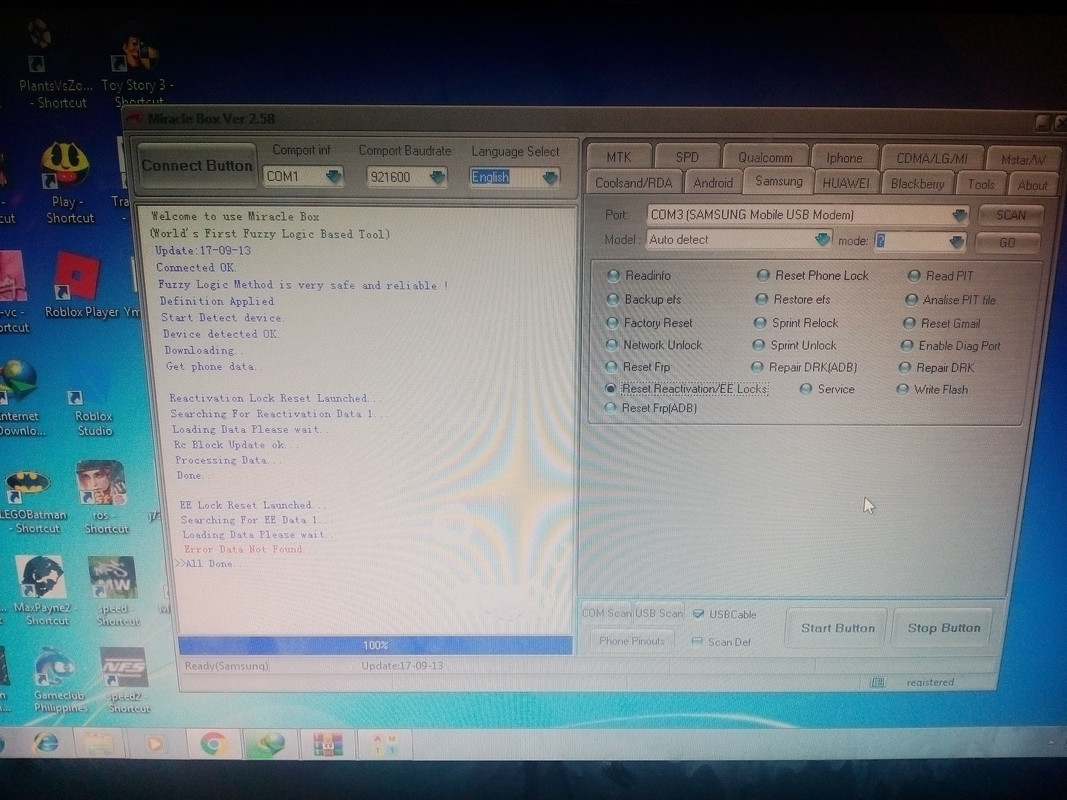

Problem

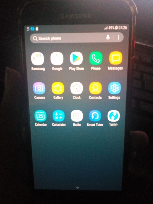

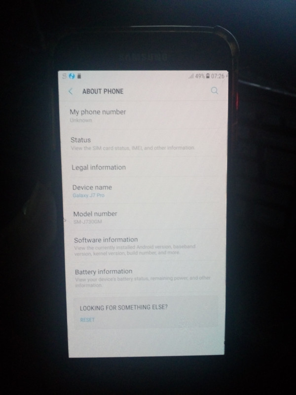

Can touch after update then missing oem
Solution
open micracle crack
windows screenshot tool
select samsung then reset activation ee/unlock
picture upload sites
para ma fix na flash odin oem >>> https://www.mediafire.com/file/ri84...4_QB19676257_REV00_user_low_ship.tar.md5/file

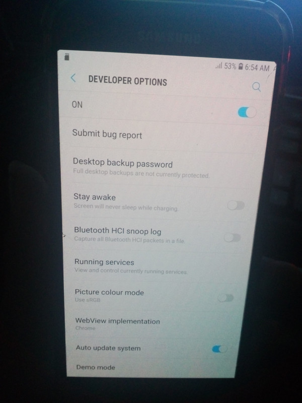

merong ng oem proceed next step
https://www.youtube.com/watch?v=4zOHFjCuATQ
follow lang video

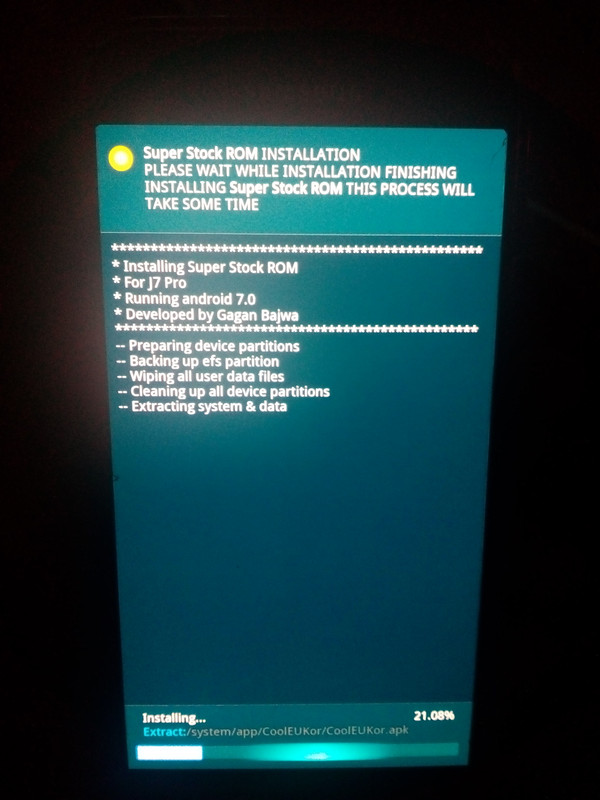

File Fix https://123link.pro/xBOe

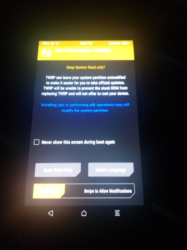

TWRP https://123link.pro/jwhZq
