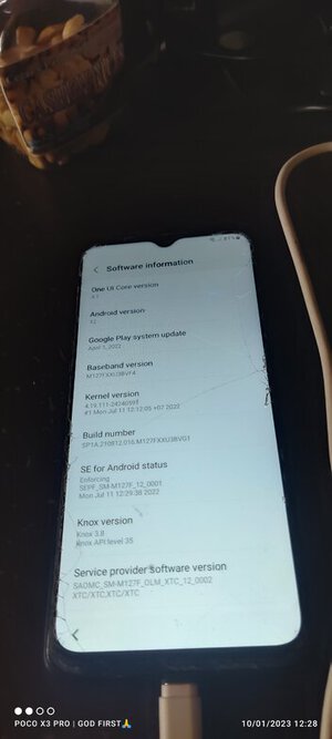

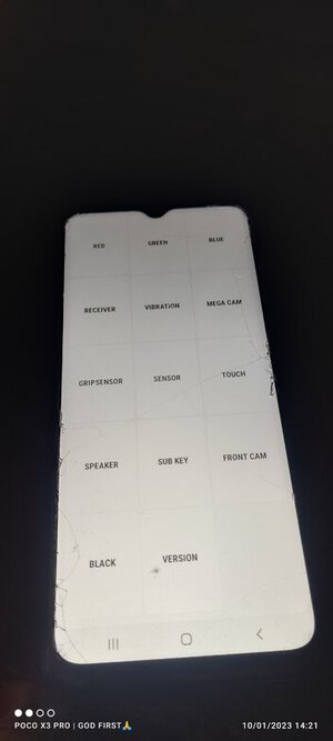

NAKA ANDROID 12
PROCEDURE

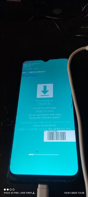

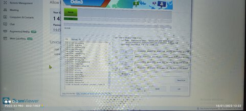

DOWNGRADE TO ANDROID 11

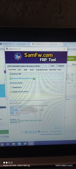

at gumamit ng free tool to remove FRP LATEST PATCH
Link ng tool sa pag remove ng frp
Link:https://androidfilehost.com/?fid=14871746926876835679

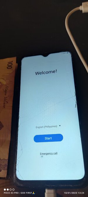

dial sa cp TESTMODE
*#0*#
saksak USB CABLE
hanapin c testmode
choose REMOVE FRP AUG 2022 SECURITY

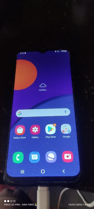

at wait nlng mag done
pic para masundan
done
