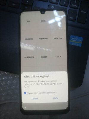

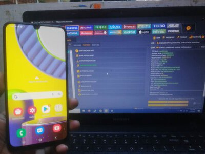

petmalu25 Registered Joined Mar 19, 2021 Messages 88 Reaction score 227 Points 221 Location Taguig City Feb 2, 2023 #1 samsung m31 remove frp done open unlocktool click samsung tab security then functions click [COM]remove frp 2022 connect usb cable na naka normal mode then go to emergency call dial *#0*# bantay sa lalabas sa phone and check allow hanggang matapos done.
