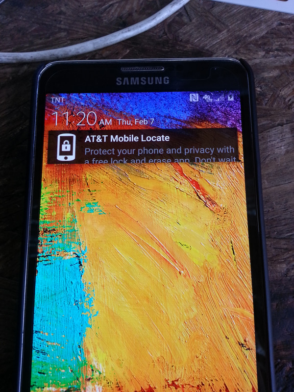

share ko lang po Samsung Note 3 lock s AT&T direct unlock s Z3X
yan po

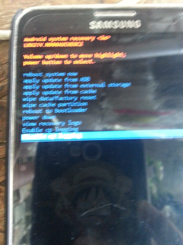

una po punta muna s recovery at "enable cp logging"
ksi po ndi mgcoconnect khit anung gwin nyo usb not
recognized kpag ndi nka enable yan

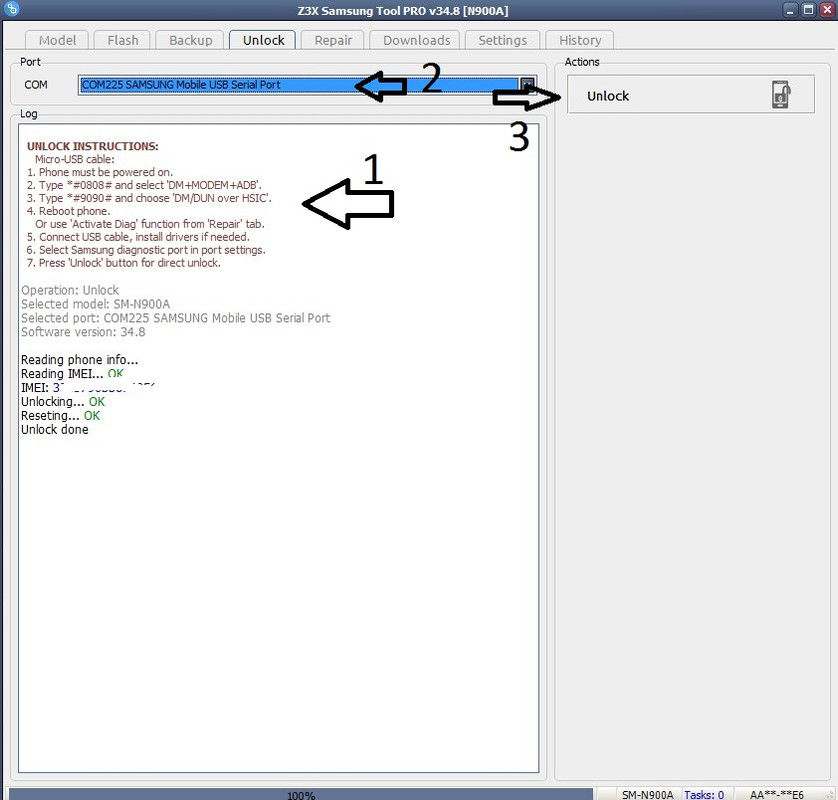

after po nyan sundan n lng instruction s Z3x gya ng nsa pics

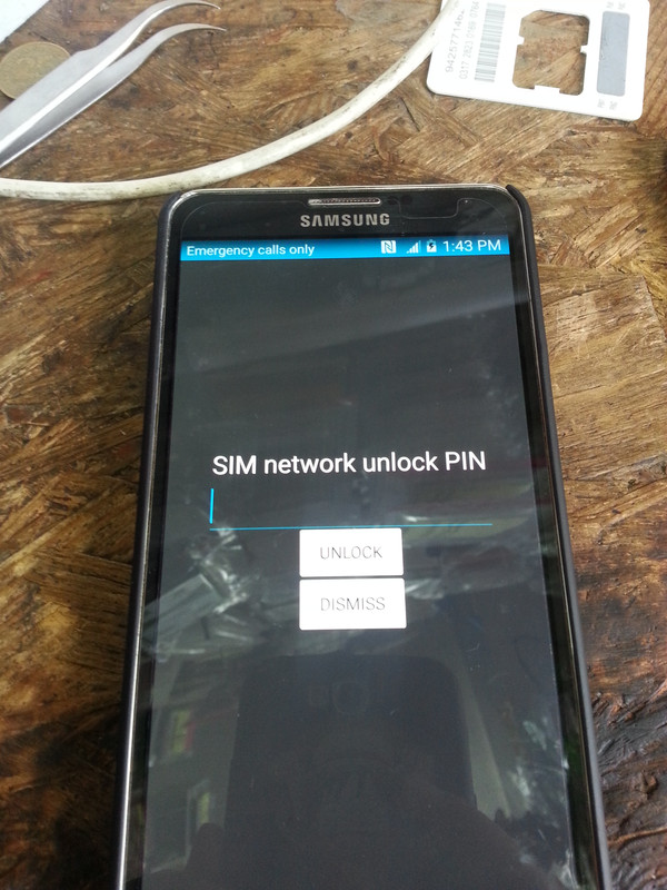

e2 po done n...
